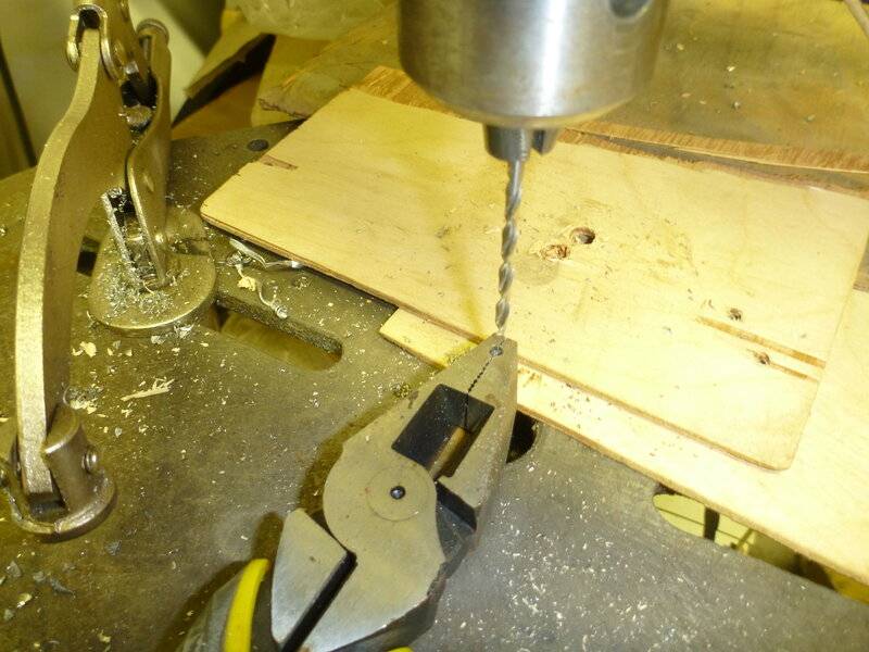

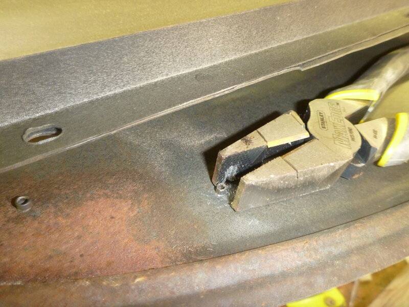

How you might ask? Take a punch and drive the core out the center piece of the rivit. Down into the dash . Then. With a pair of needle nose vise grips on the underside of the dash squeeze the flared part of the rivet enough to remove the Vin tag and rivits out of its original holes. This might take going around the rivit several times to round and reduce the diameter of the flared part of the rivits to get it through the factory holes without enlarging them. Then use some generic steel poprivits and rob the center pin out of them and put them in your original Rosette oem rivits and pop them back into its original place after the vin tag or dash has been restored. $$ saved!

Yep.... :D
