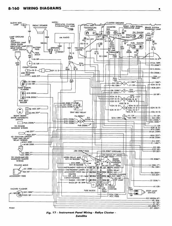

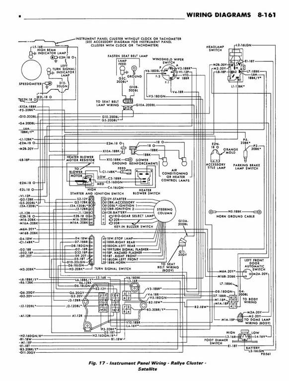

Do yourself a favor and get a copy of the factory service manual for your car, the wiring diagrams for both the non-rallye and rallye dash boards are side by side. Short of an entire replacement rallye dash harness, to modify the non-rallye harness is doable; you will need at least the cluster portion of a rallye dash harness with the discreet light bulb sockets or equivalent. The voltage limiter is different mechanically in how it is mounted/wired, shouldn’t have too much trouble locating the correct one. Will need to relocate the wiper switch wiring as well.
From the 72' FSM;

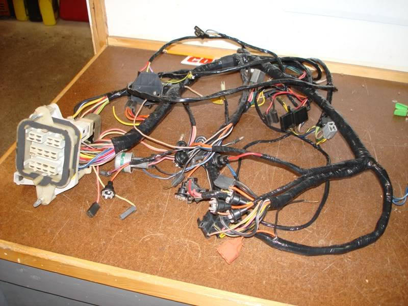

Recently non-rallye to rallye converted/rebuilt dash harness.
There are 3 different harnesses. 71 72/3 and 74. The pinout at the bulk head changed for each set. If you use a dash harness other than 74 you'll have to color match the wires between the dash harness and the motor/front harnesses.
From the 72' FSM;

i am new to this site , just joined. i am in the process of restmoding my 73 satellite/sebring . i am in the process of changing the gauge cluster . i am going with the rally gauges instead of the standard ones , i have the 150 mph speedo from a charger as well as the complete under dash harness. i also have the harness that was in my car . neither are cut up or damaged . i originally thought that this was gonna b an easy swap ( boy was i wrong ) . i have found that most wires r the same but there r different wires that dont match my car. im getting soooo frustrated. i am considering trying to take the tape off of each section (one section at a time ) and trace each wire and possibly remove what i dont need and keep what i do need. is this a feesable plan of attack ? please help. u seem to know a good bit about this according to what all u have wrote.
As Moparmarks mentioned, in the four years that dash layout was used in the b-body there were several variations depending on options and additional circuits for both non and rallye clusters. Later cars had seat belt warning lights and buzzers, seatbelt interlock systems, two speed vs. 3 speed wipers are wired slightly differently as well as relocated in the cluster. Get a factory service manual for the year car you have if you don’t already have one, it will have detailed schematics for both non and rallye clusters showing specific circuits that match your car. Diagram I posted is from the 72’ FSM and may not be 100% correct for 73’. Use the original harness as a reference. You may have to move a few connectors around the bulkhead connector cavities to match and/or remove some wiring related to components your car is not equipped with.
