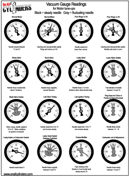

I would get a vacuum gauge and use this chart to see what the problem might be.

Will do on the new rocker shafts. I own a vacuum gauge but haven't relied on it much. I'll be sure to read up and the chart Mick56 posted is going to help get me started. I wish I had a known-good carburetor to throw on there for diagnostics. I may go back into mine to clean it up (again) and make sure everything is moving freely too. If it comes down to it and I can't prove it's anything else I may throw an ignition box at it too.
In the olden days, a vacuum gauge was usually the main diagnostic tool.

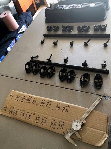

It's been a few months and I finally got back into this thing. Who had their money on worn out valve train AND bad lifter AND fuel pressure issues AND defective cap and/or rotor?
Turns out it takes more than one problem to have the RPM wander up and down 450 RPM at idle. I'm very close to having it completely sorted out as of today, I've got to clean the fuel pickup out (the junk that came out when I flushed the steel line to the tank was unbelievable). I have a fuel pressure gauge right at the carb that's showing a slight fluctuation of about .5 PSI, from 6 down to 5.5 and an accompanying RPM drop off of about 150RPM a second or so later. It's considerably better than what I had when I posted this but still needs attention.
I replaced the cap & rotor again, I'm not sure why but I can tell the Blue Streak set is making better spark than the bargain brand was making. It's possible the rotor was warped or the contacts were too far apart - whatever it was it definitely didn't help my idle RPM.
There was a lifter in one hole that was spongy compared to the rest. It was smooth and clean on the cam surface. I threw a new one in just to eliminate that as a possible issue.
Here's the details of the part I found most interesting. A lot of people have told me loose rocker shafts and play in the rockers on these motors is normal. Mine wasn't (Wietse you called that). The rocker mounting hole elongation was extreme in my case, and it was definitely exacerbating my idle issues. The measurements are below but long story short - there was as much as .050" of elongation in multiple rockers (there are two measurements for each rocker as they have a hole on each side). Nearly all of them were elongated enough to impact valve function.
There was a little variation in the new set I got from Mancini, but it was nothing like what had developed with mine.
The center set of measurements are my old sets, and the outer measurements are the replacement in the bottom photo. I could tell you by ear, the second I fired it up, the stumble I was chasing was gone and it revved and felt like I'd swapped the cam. I highly recommend anyone with an idle miss or a ton of miles on one of these check for this issue.
I appreciate everyone's ideas on what contributed to this problem. Everyone's suggestions led me to investigate and either solve or eliminate an issue. I sincerely hope I'm able to pay forward the good advice and troubleshooting pointers everyone here has offered. Expect a follow up video of perfectly stable RPM once I get done cleaning out the tank and sender/pickup.

Strange thing that only some of the old rockers had so much elongation and some were still close the OEM specs, maybe a few were already replaced in the past by a previous owner or so?
You would say they wear out evenly all together.
