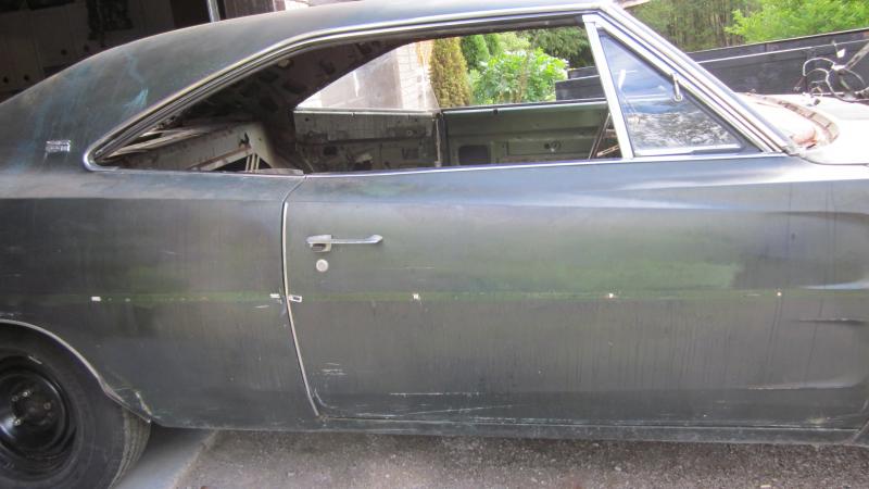

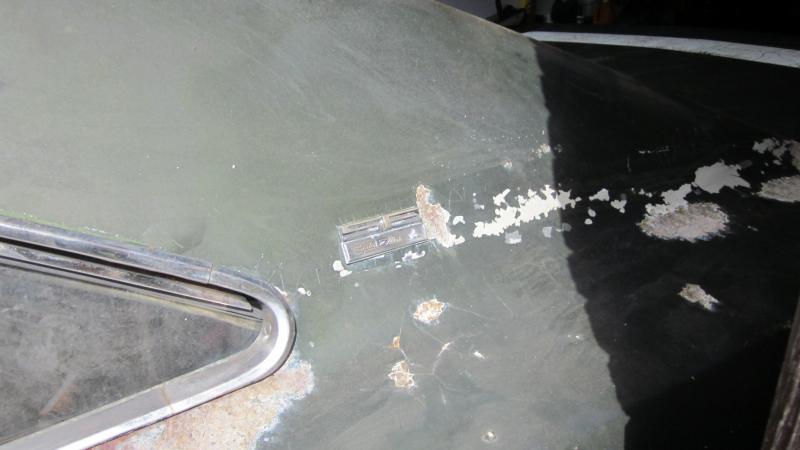

Here are some pics of right and left side of a R/T SE with se badging. this will give you an idea of placement on your new quarters. as far as i can see on new badges there is no difference on left or right and looking on car at old ones. hope this helps Steven

Oh yes Thanks a lot!
Could I get you to measure from the drip rail molding over to the edge of emblem?
Thanks!
It is 2 3/16 inches from middle of curve on drip rail to edge where it says special edition on the emdlem
