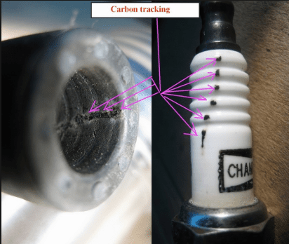

By your description below I believe you have a secondary ignition misfire. Here's some things to look for.
Forgive me if you skills are beyond these suggestions.
"By twitsch i mean a slight missfire like biheivior no popping or backfire just a irratik slight interfierens thruout the whole rpm range like when a plugwire arks over to the headers hawe no headers thow ."
I know your parts are new but spark plugs can crack when installed.
I also would recommend google translate for your language barrier. by the way - NICE CAR!!!!
One of these would come in handy for diagnosing a ignition misfire.
Ok that sounds like it but where?

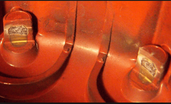

Top photo, in 1972GY8SE's post, is the inside of the distributor cap. He's telling you to look at it.
Cap and rotor are two parts, besides others, that get replaced when doing a good tune-up.
One thing that might help, is run the engine, at night, lights out, hood up, and watch for sparks. Sparks would mean those parts are bad, and need to be replaced.

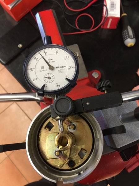

Is this the cam for counter-clockvise rotation ?

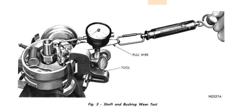

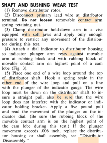

The play is 0.012 inch it means that the pickup gap of 0.008 vill not be konstant the rotor vill hit the pickup is this the problem ?!
0.012 inch is excessive depending on the amount of force used for test.
Is this causing your misfire????

View attachment 760223 The play is 0.012 inch it means that the pickup gap of 0.008 vill not be konstant the rotor vill hit the pickup is this the problem ?!
.012" play is not that bad, a spinning shaft tends to run on center. There is no real load on the shaft, anyways.
The air gap being .008" is not really that critical, I've ran them as wide as .016" with no trouble.

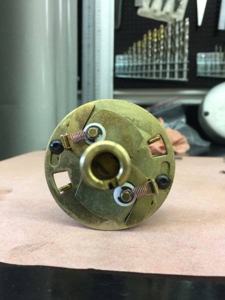

The advance springs in the picture you posted look really light.
Your timing would be, all in, very early with light springs.

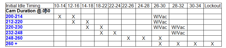

Do you know your cam duration specs @.050 lift?
What rpm does the car idle at?
What is your base timing?
What is your total timing?
What rpm is total timing in at?
Are you running vacuum advance?
If so, what is timing at idle with vacuum hooked up?
To be on the safe side got a new distr. did not solve the problem regarding timing hawe tried everything now 11 at idle 38 total at 2500 its not the timeing ! Idle 700-750 whit warm engine .Vacum moves sligtly between 16-17 slow movment .Pulled valvecovers vill check lifters did not check them at rebuild so vill do it now .
I don't know about the fuel in Sweden but in Canada, our fuel contains 10 to 20% ethanol. It is very light in specific gravity and very volatile. 38* total wouldn't work here unless you had 8:1 compression and a huge cam. Most big block mopars like about 34* total. All in at 2500rpm is ...ok, my personal preference is 2800 to 3200rpm with a vacuum advance distributor.
Here is a chart that may help you with timing dependent on cam specs.
We hawe 98 octane and I add octane booster at evey fillup .If the problem was timeing related it would not follow the rpm from idle to wot whitout changeing .
