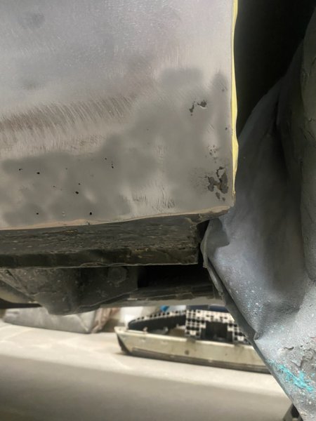

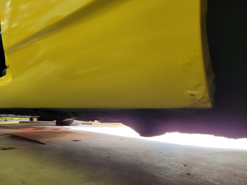

I had these on the Bird when I bought it in 1990, that grew ever so slightly over 33 years! What we found when we stripped it down last year... easy repair, but then again we were painting the entire side of the car!

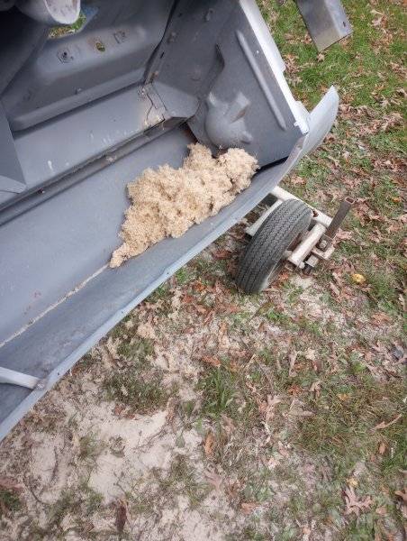

I'd say that is likely rusting from the inside out. My car is a California car and has similar. The water/dirt/condensation runs down the inner panel and collects on the back side where there is just a small gap between the inner and outer.
Mine is opened up right now, I'll try to attach a picture later.

Water and rat turds just sit in the tight areas and causes rust from the inside out. The rest of the rocker is great, but the back corner where the metal overlaps very closely is where the issues lie.
The backside of that panel will be full of rust pits all along that panel. To do it right that entire lower 6" of the quarter needs to be cut off and then blast the trunk extension (I am sure it has pits to) and then a patch panel welded on. What you see is only about 10% of what is actually needing to be replaced to never have this problem again. I would just leave it until you are ready to fix it right. The only thing I may do is shoot some cavity wax down there to try to slow it down.
