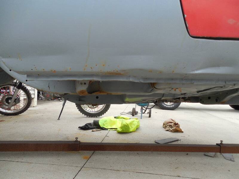

Hi all,
I am looking for some info on what is the recommended product. Basically surface rust. Zero rot just want to stop is from getting worse

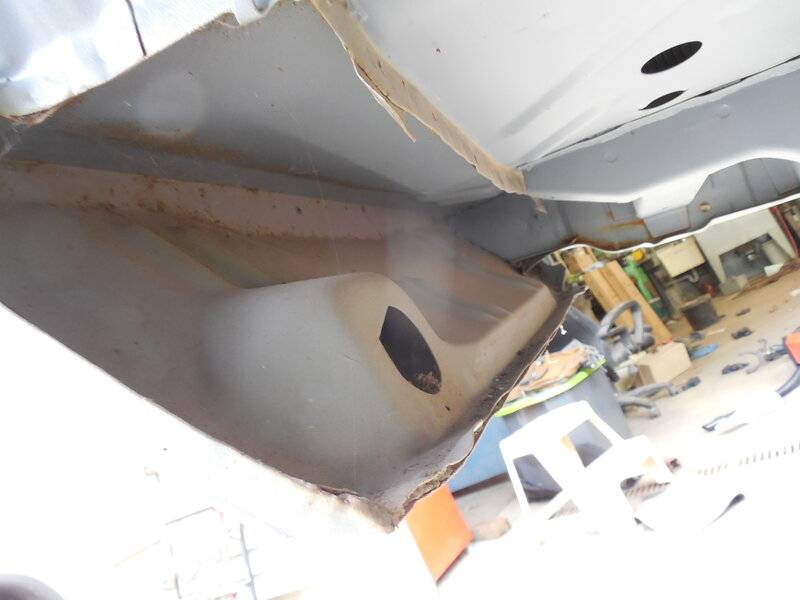

I have used quite a few cans of Eastwoods converter/encapsulator. It comes with nozzle extensions and it's great for inside frame rails, floor cross members, and inside doors and such. Hood and deck lid reinforcements too. It will creep into lap seams also.

Pretty hard to remove rust inside frame rails and lap welded seams.

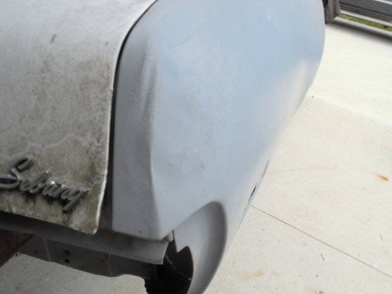

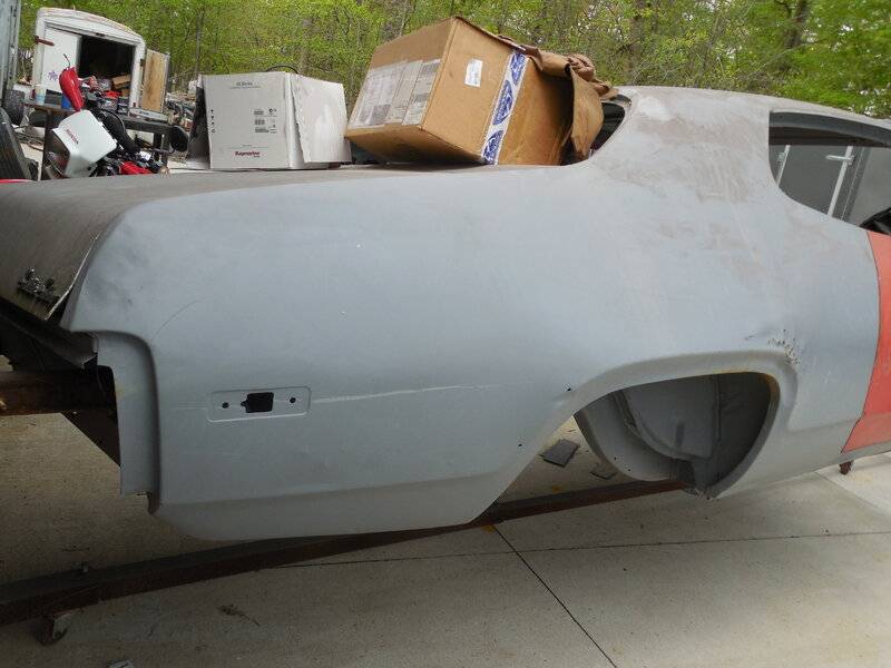

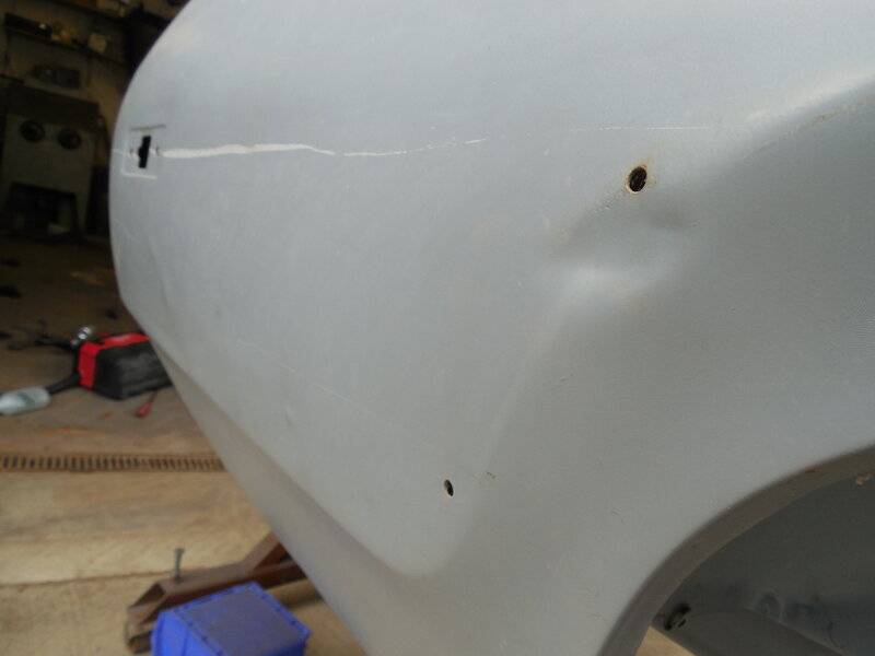

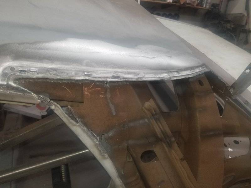

So the more I look at the 1/4 panel the more I think it does not need a complete replacement. Now I am no body guy but I feel I would be better off replacing the bad area. Opinions are welcome thanks guy's
A decent body guy should be able to get those pretty straight without too much trouble.
The worst parts are the screw holes...that gets tricky.
My thoughts we're to get a smaller panel and cut out what I need. Then weld it in that way I retain as much original as possible.
The drivers side had rot and was more damaged.
