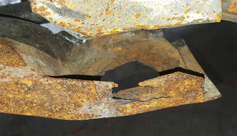

My k-frame mount holes towards the rear of the car is rusty, thinking that if i weld it up it might weaken it overall. Has anyone done this? did it come out ok?
Wondering if i'm better off trying to find a new one, from what i understand any 73-79 dodge charger, dodge magnum, plymouth satellite, roadrunner or gtx should be the same?
Car used to have a 400, now it wil be a 440 with shumacher engine mounts.

I suggest getting a different k-member. If the engine is out, they're not all that tough to install.
give a chance to find another one, althought that one is fixable.
yes, all 73/79 B bodies are the same, just need to get the one for Big Block to save from mount adaptors
Hard to find at a reasonable price, would prefer local pickup in NJ, NY or PA... will have to hunt one down i guess...
I agree with Nacho, that is fixable. If you have fabrication and welding skills it can be done. If you will be snding it out for repair the cost might be prohibitive, find a better one in that case.
if fixing, just need to be sure the oval opening being perfectly centered to be sure the correct alignment with front rails.
you can find also another one damaged but healthy on those ends no matter if BB or SB, to cut and weld the piece.
or a perfect small block one ( which are way more ) and swap the engine mounts from one to the other
Sand blasting for starters. This will determine if your frame has further damage. For the cost of blasting and potential for heat deterioration due to repairs, I recommend locating a big block k-frame. Potentially your lower control arms and other components have a similar problem. Best find a complete unit and build it out from a donor car.
i got all new PST stuff... just need the k-frame at this point. I have the skill to do it, not the tools, something like that i would want to chamfer & tig weld, probably leave the welds on the outside without grinding it... all i have is a mig.
