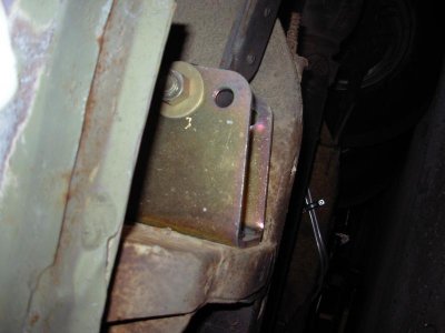

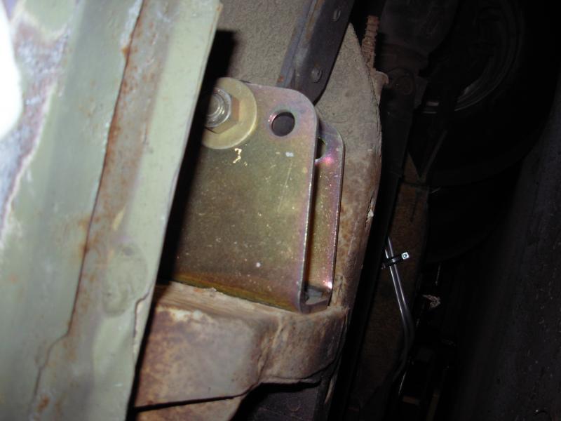

All SS springs have 20" front segments.Thats why b and e bodies need special front spring perches.Like the ones in the pic.You can get away with running standard perches if you run smaller tires.
