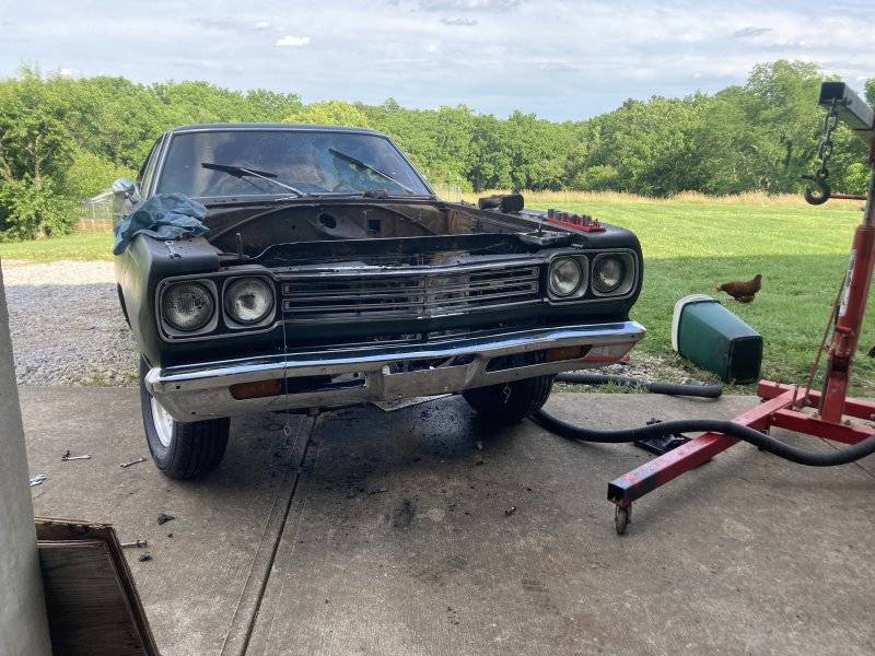

Sad day for the Roadrunner…

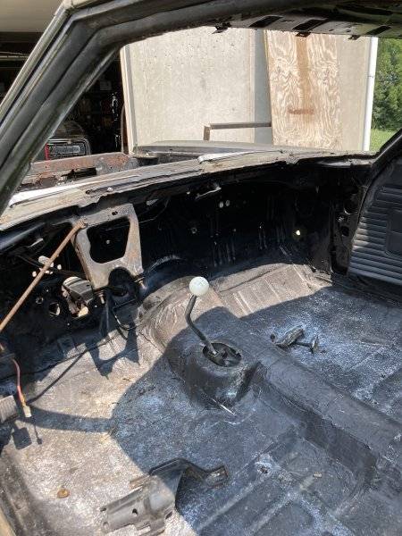

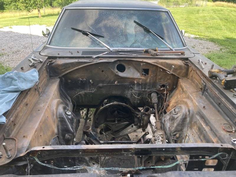

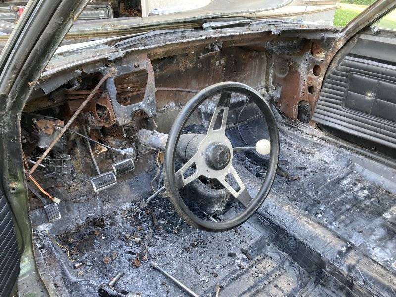

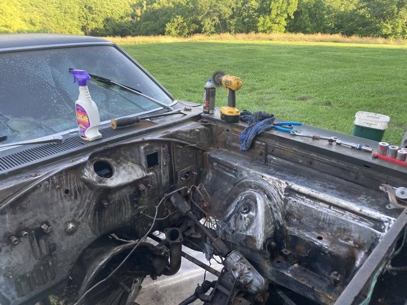

Yes. They gave me 75% of what I had it insured for so I got to keep the title to the car which I was really happy about. I took out the engine and what was left of the interior, dash, air box, etc.. I sanded down the engine bay to bare metal and hit it with some primer. Next will be wire wheeling what I can of the roof and inner structure and painting it and putting in some dynamat. I got a good start and it’s going better than I thought.
Ugh, what a mess.

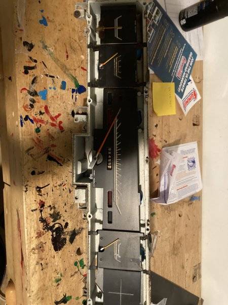

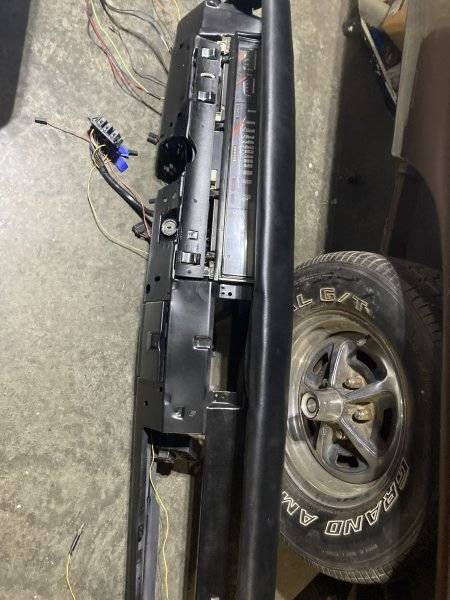

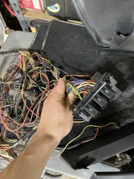

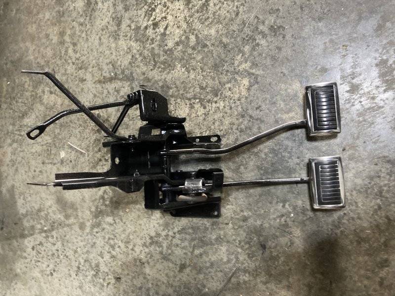

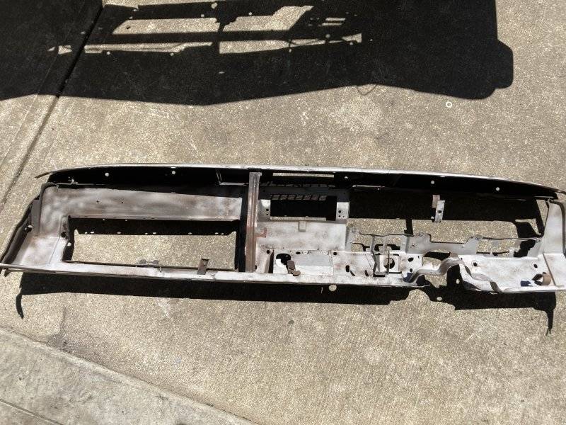

Yeah sorry I haven’t been updating this thread that much. It’s mostly just been sandblasting and painting small parts and resorting other used karts I got. I got a used dash harness from a buddy. He just gave it to me along with a new bulkhead connector. I’m not sure if I’m going to run it though because it’s used and I don’t want to have this incident happen again but there’s no burnt or shredded wires on it. It does need a new fuse box. If I do run it I will bypass the main wire going to the ammeter.

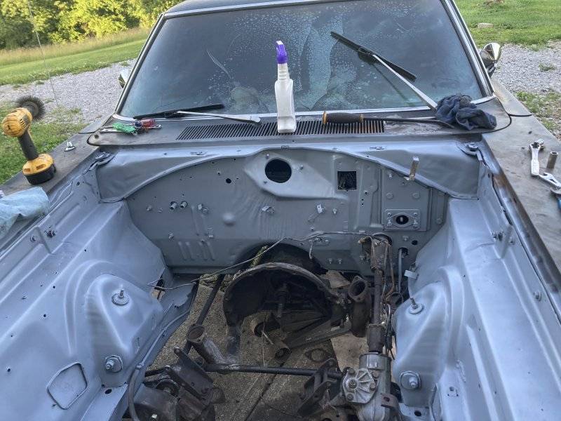

The paint on the engine bay looks bad but that’s due to the car sitting outside and dirt collecting in it. It looks really good underneath the dirt. Same for the inside of the car.

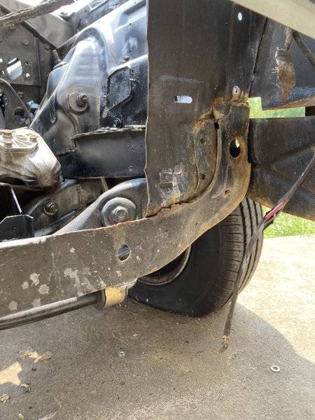

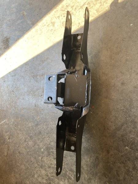

Next I need to put a new core support on the car because mine was damaged ever since I bought it.

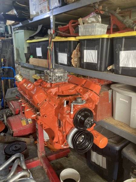

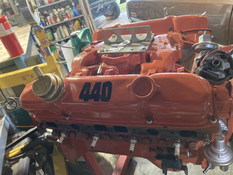

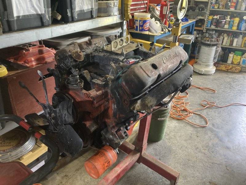

As far as the engine goes, there no damage to it. I checked the cylinders with a bore scope. I will be putting in a bigger cam and some headers and an aluminum intake. Then I’ll touch up the paint.
