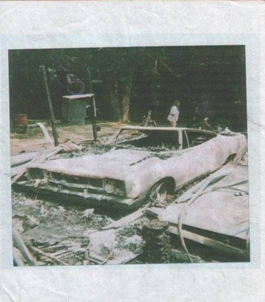

That really hurts to look at, but it could have been far worse. This was my '69 road runner, and my Uncle's '69 300 convertible. Best reason for a detatched garage. You can rebuild yours.

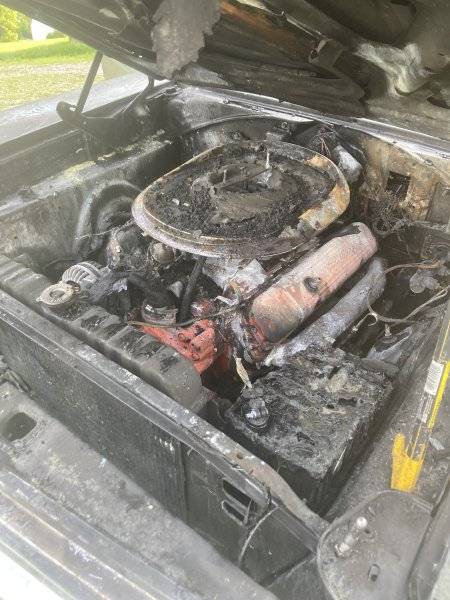

What strikes me odd about assuming electricity was the actual or sole cause is that the car was off.
No power would have been flowing.
I would think the wires would have been cooling from any problems?
I HAVE had an original meltdown of a 1973 vintage firewall bundle on my way to work.
I had driven 35 miles and was exiting the interstate when the A body died.
Just melted wires.

Continuity from the battery thru the ammeter is always there. For example headlights and brake light work regardless of key position.

Well today was alignment day for the roadrunner. After getting all new ball joint, tie rods, control arms and bushings for the roadrunner I took it out for a front end alignment to a very trusted place that have aligned many cars for my family. I got it done and it drove the best it’s ever drove everything was good and drive home was just fine. I parked it in the garage and walked away and about an hour later my sister smelled smoke and she opened the door to the garage and sure enough smoke was everywhere and so she ran and got me and I saw fire from underneath the car. My dad and brother came out and got the car In neutral and shoved it out into the driveway and hosed it down. I’m still in shock. Before anyone asks me, no I don’t know what caused the fire. I’m pretty sure it’s electrical because we hosed down what was left of the wiring harness and it was hissing really loud. It’s still the original wiring. Not sure what I’m going to do except call the insurance company and have them assess the damage, they’re more than likely going to total it. It’s really not all that bad. If I where to rebuild it I would need a new interior, wiring, check brake and fuel lines, check all the rubber and I’m probably going to have to pull the motor and check it out and do all of the other little odds and ends. Any other things I should look for or inspect or do before the inspection for the insurance company?
Just for this reason I've never had an attached garage! I know soooo many that have had car fires where it burned down the house too. Anyways, I just disconnected the battery on my 64 Dart after letting it sit for a month along with the 96 Dakota and 97 diesel. Oh man....to lose a car or a house due to a car fire has to suck. I'm so sorry for you having to deal with this!!
Of course that wiring would have to short to ground and I would be sceptical of that happen in a wire bundle.
Chafing somewhere?
Not that many places it could the way it's built by Chrysler, but possible I suppose.
The other thing would require the circuit to be active and overloaded.
(Lights left on the the daytime??)
That usually just melts wire(s).
So I'm out of ideas.
