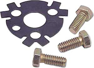

Have seen a bolt locking plate for Chevs, but not for Mopars. Like so-
This would be the best way to go if concerned, but looks as if one would have to make it.
