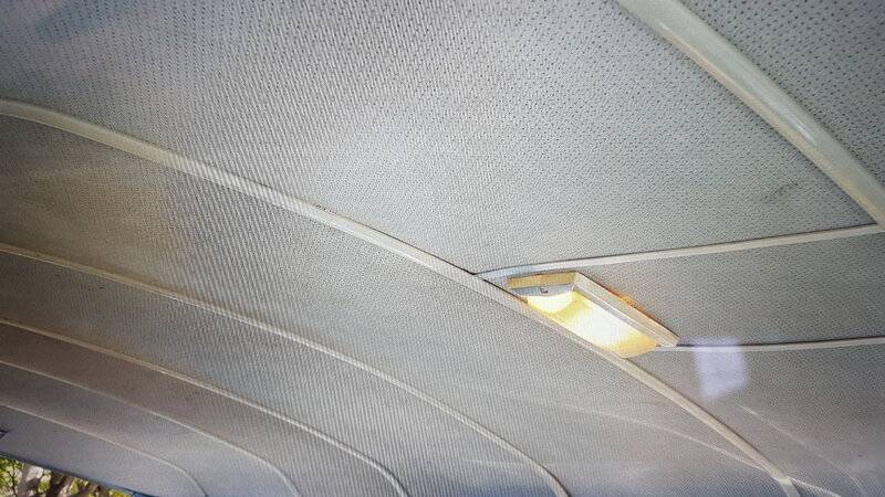

I have 62 Fury with a sagging hardboard headliner. It’s in good shape and you can push it up but it pops back down between the bows. 62 Plymouth’s and Dodges have a very flat roof otherwise It would probably stay. Any easy fixes for this?

The original hardboards were sagging mostly from warpage. Moisture can get to them and once dried out they stay that way. That's why I replaced them with the reproduction ones.
I took 2 strips of aluminum from a big box store and bridged the gap, just cut to fit and slid them in.
Been in there at least 4 years.
Carboard would only stay up a few minutes without support, it was just too short in that one section, must have shrunk.
