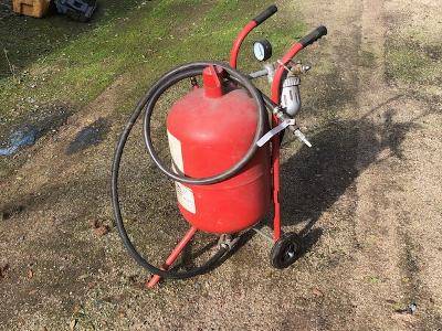

Sandblaster replacement hose....
Its a "suction" hose - there's no pressure in it at all. The key is flexibility - you do not want this hose to kink.
I still question the 10'. This hose connects to the top of the pickup tube - it really doesn't need to be any longer than a couple feet.
Here is what it looks like:

The unit is portable, not bench mounted. Because of that, it needs a long hose to be able to access places like inside of a trunk, engine bay, interiors, etc. A 3 foot hose on this would be useless.

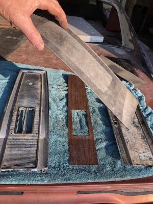

I did clear the blockage today. A coat hanger did the trick. Now I have to get some sand for it. I'm going to buy a blast cabinet as well for smaller parts. I'm guessing that the sand can be reused a few times, right? I'm going to blast the top plates for a center console so I can paint them.
I wouldn't do those with sand !! The most versatile media I've found is aluminum oxide (for a cabinet-style blaster). The finer stuff will leave a finish as fine as glass beads BUT it lasts much longer. The problem with glass beads as well as many other media is that they shatter every time they blast something. eventually they're just useless powder. This doesn't happen with aluminum oxide.

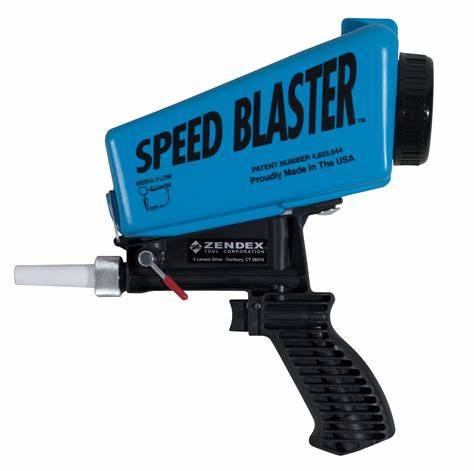

Glass beads or soda Greg for that. Light psi as in 35 to 50 psi for the glass beads. I've never used the soda but plan to soon have 50 lb bag out in the shop ready for one of those little guns. Now for small parts like that one of those cheap self contained hand held soda media blasters would be best. Not like your doing the entire car right? This is the one I have. Works great but just never used it with soda.

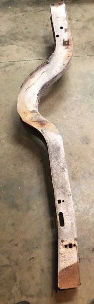

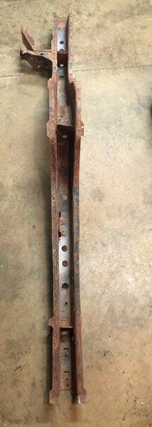

I have pretty much the same blaster. I’ve had good success with glass beads. I was also able to reuse them 3X’s by sifting the garbage out. I bought some plastic media but haven’t tried it yet.
Rear frame rail before & after with glass beads:

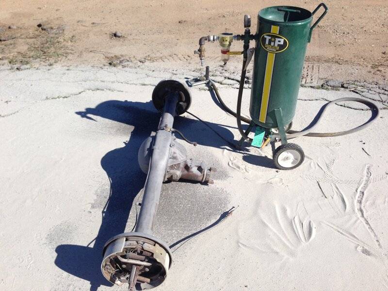

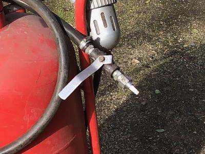

It is. The hose itself attaches to the bottom of the tank and had a cheapie 1/4 turn valve at the end instead of a gun type handle with a trigger. I got this thing from a guy that just wanted to clear out his garage. It may have been cobbled together.
"KD"

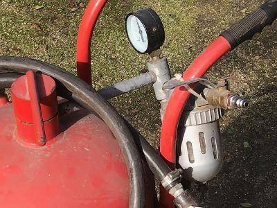

I have a TIP
See pic:
Sometimes I have to remove the bottom Valve and clear it out.
Try that if you can...as debris can cause a flow restriction
