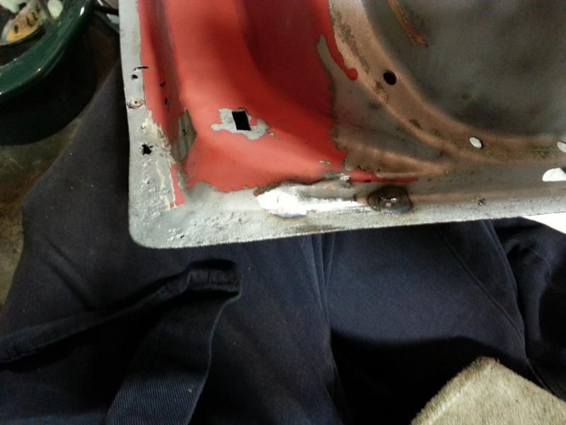

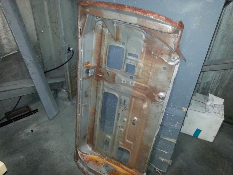

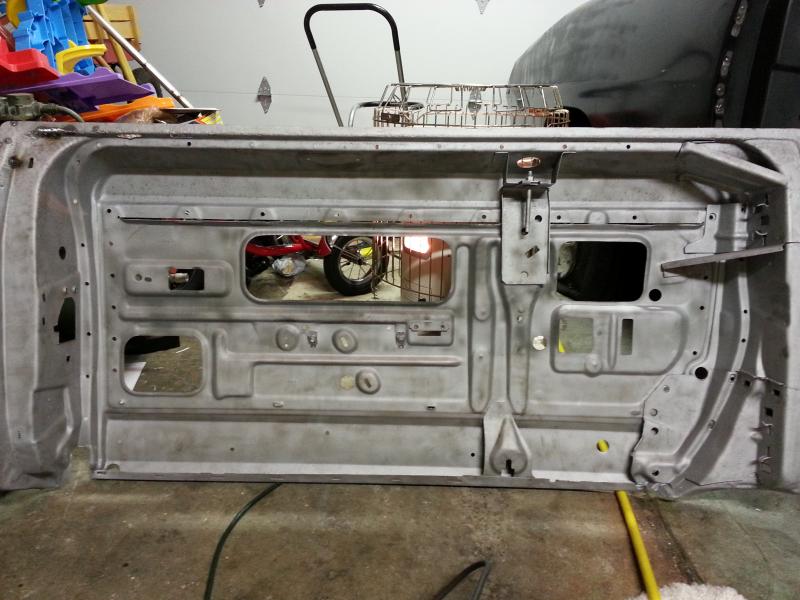

Well, I figured I better get back up on that horse. I've been doing small stuff, hardware, window regulators, and door internals. I got my driver side door out and started sanding it down. Come to find out someone has been tap dancing on the lower rear corner. After some sandblasting I came to the conclusion I need a door skin. 20140305_150941.jpg

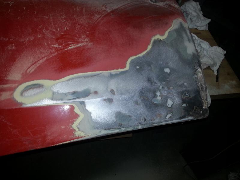

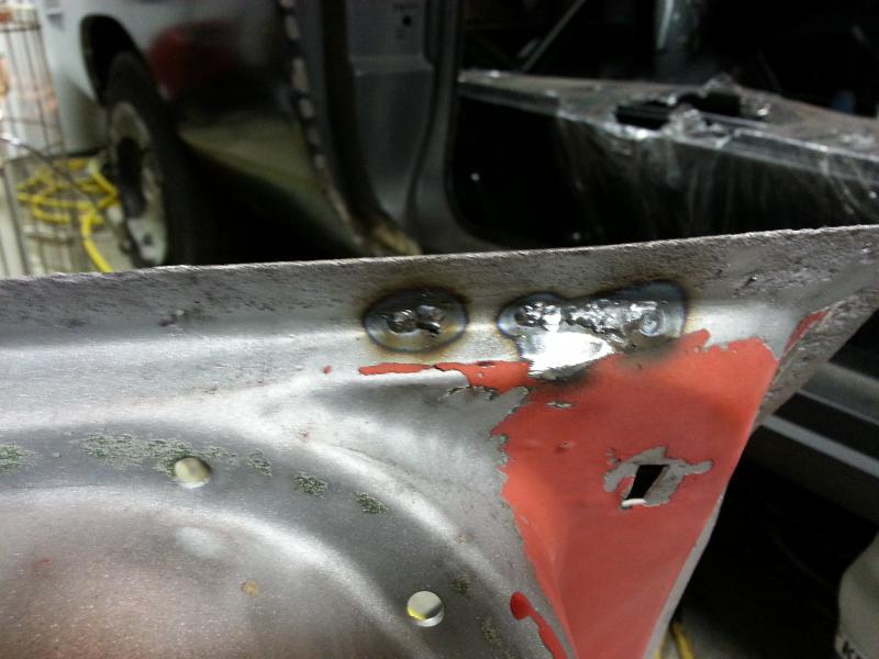

I started by grinding the edges starting at the bottom edge until a thin line started to appear. Mine started to separate by itself and the rest was done with light pressure and a screwdriver. Afterwards I marked and grinded the spot welds off.20140313_121420.jpg

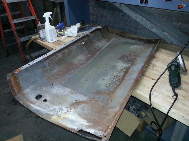

Next step, sandblasting. Came out pretty good but ran out of sand though. Have a few holes but a little welding will fix that.20140314_210047.jpg20140314_204833.jpg20140314_204136.jpg20140314_204833.jpg
A little more welding and grinding and I think I'll be good. Now all I need is money for a skin.

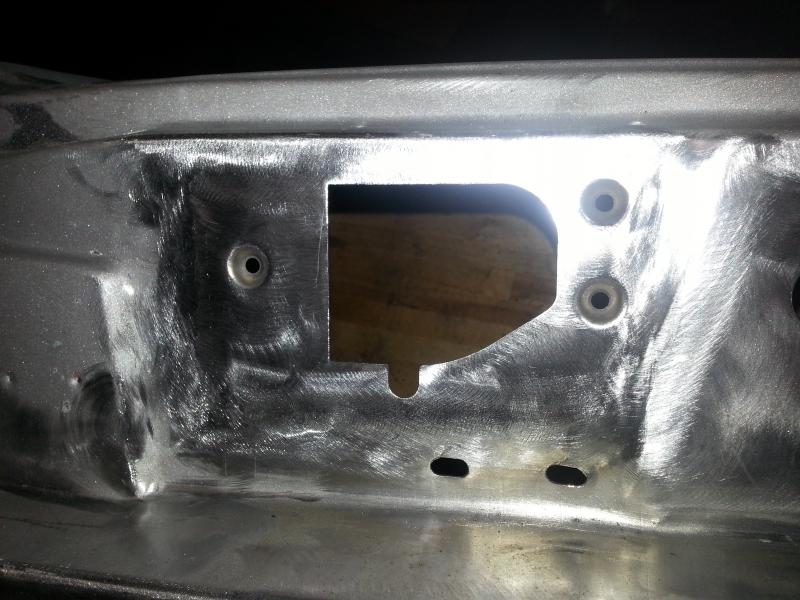

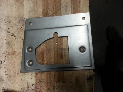

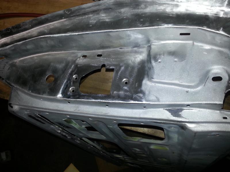

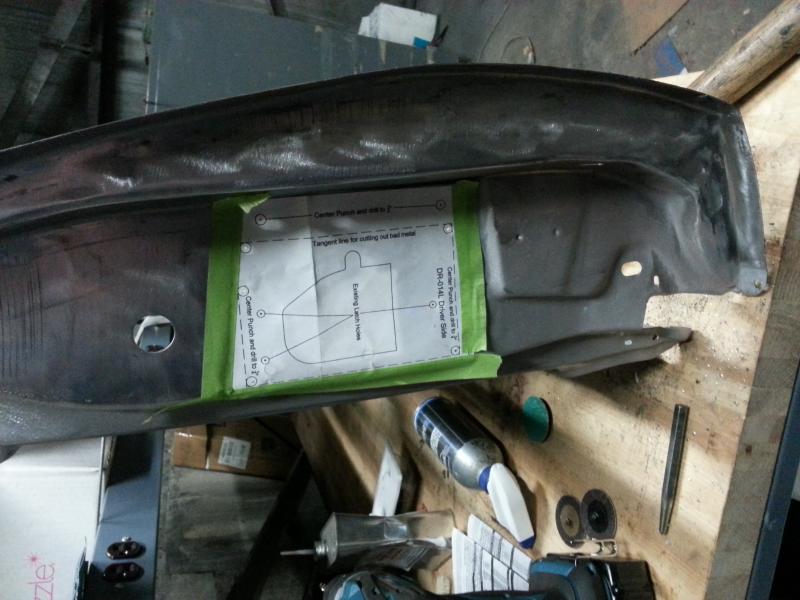

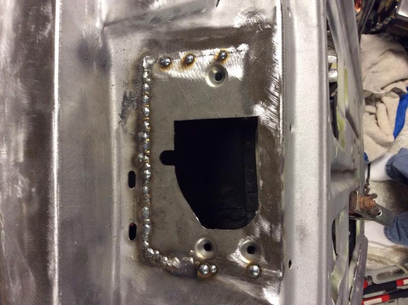

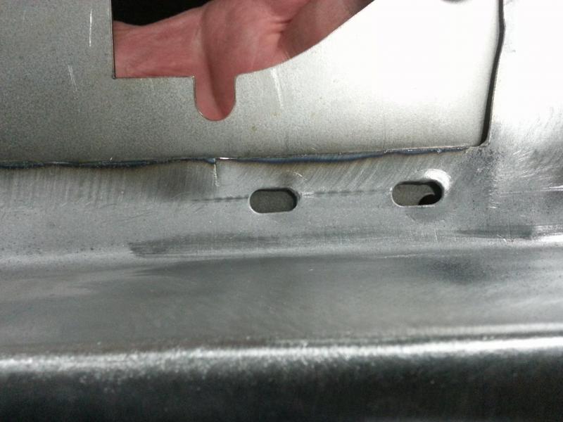

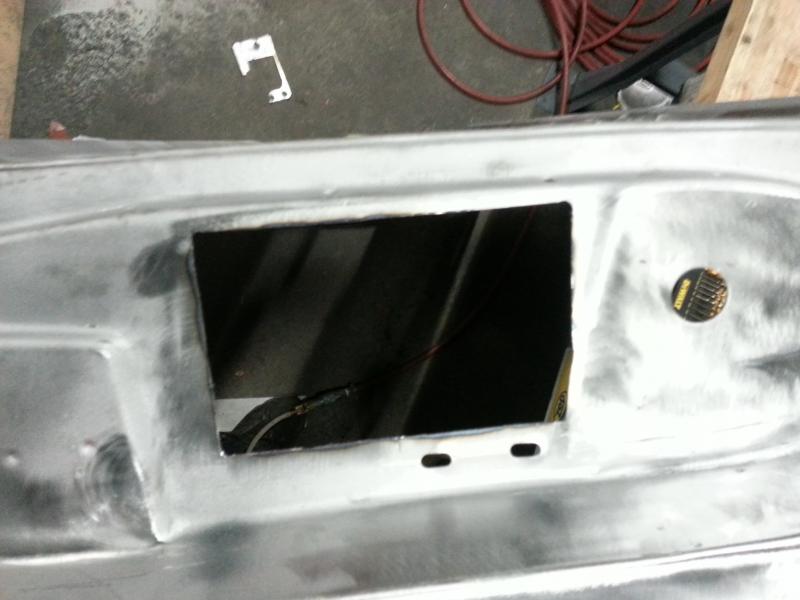

Did some more work on the driver door the past few days. Had to replace my door latch area. Mine has several cracks and one of the mounting holes is broken. While I was at WPC swap meet I picked up a patch panel. Nice little kit.
Had to do a little fabrication due to the interference with some mounting holes.

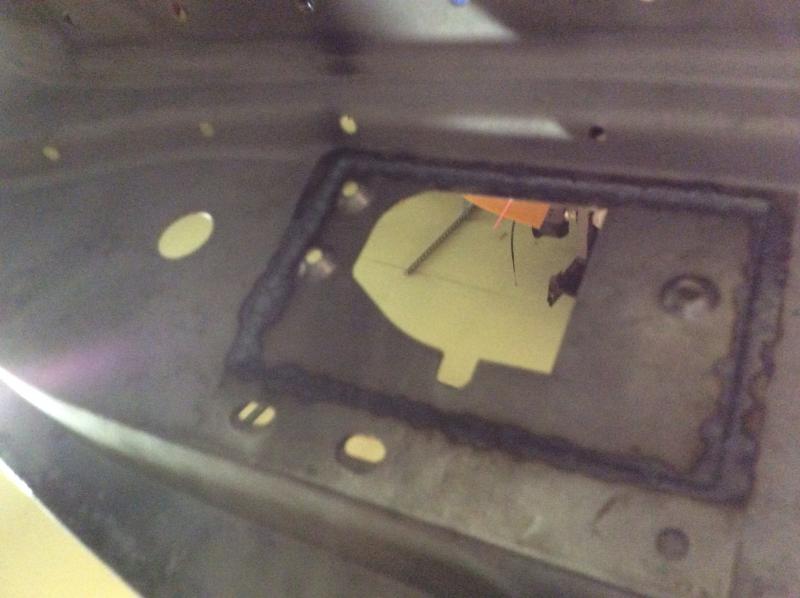

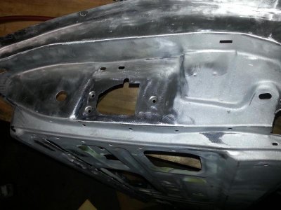

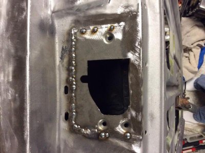

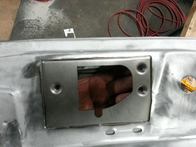

Got it all tacked in just have to do a few touch ups and more grinding.image.jpg
You can see where had to make some holes in the plate.
Other than that went in rather well. Should be getting a door skin before too long.

Well got it all cleaned up, and its much stronger. Ordered my door skin today through JEGS. They are doing free shipping and handeling on amd sheet metal as long as its not oversized. They had the best price even through 521 restorations.20140326_123741.jpg20140326_123802.jpg
