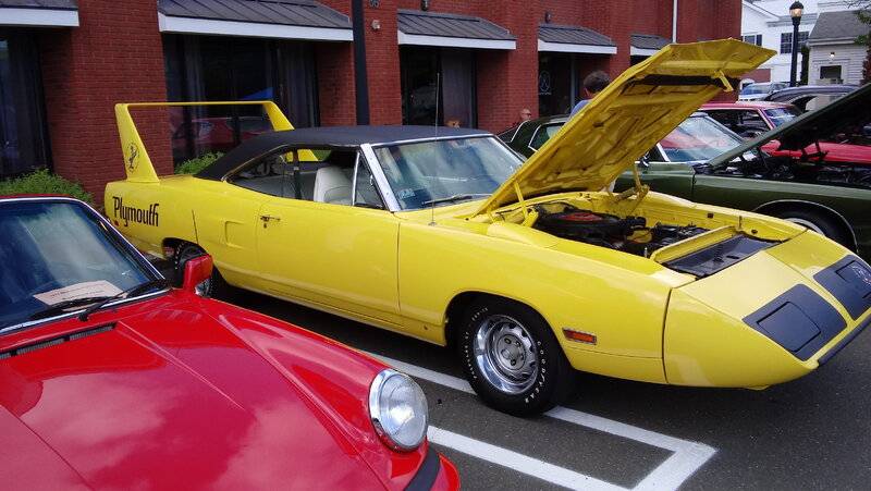

Went to our local Oyster Fest today & they had a small car show.
Has anyone attempted a miniature Daytona/Superbird on a Dart/Valiant body?

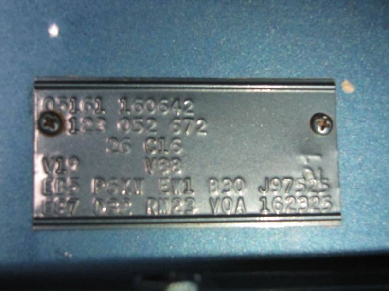

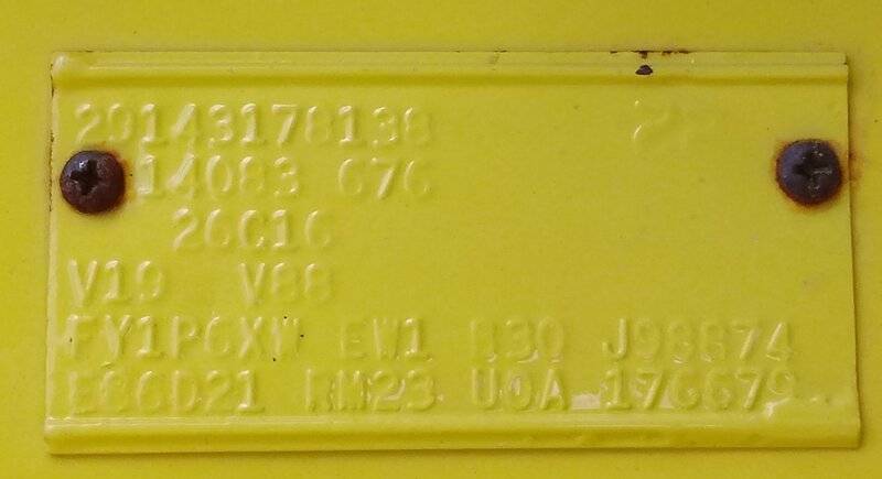

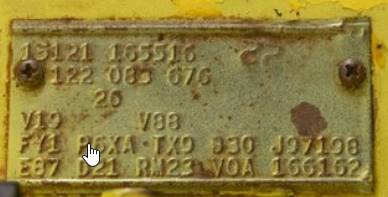

Very strange looking fender tag!!! Spacing is all messed up compared to any other tag I've seen! Reproduction?? Compare to this one.View attachment 1155995
Agree. I couldn't make head or tail out of that first tag. Looks like a repop of a lynch road tag, made in different plant format. Methinks car is clonish
The second tag is real, and much more like I would expect.

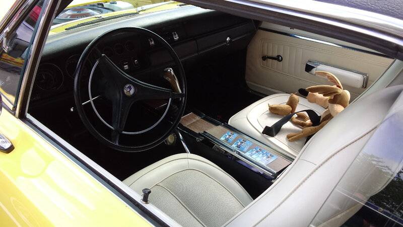

176679 is a real Bird and I suspect the tag stamper was skipping spaces as it's pretty consistent between rows. 26" radiator and C16 is console. Even has a 22 inspector stamp.. What it would look like if spaced right.
