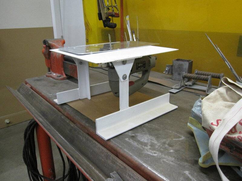

Hi fellas,
I had to use this table I made years ago for detail cutting aluminum sheet so I thought someone else could use one too. Just scrap I had in my stash. Take the sole plate off the saw and use it for a drill pattern on the top, drill a blade clearance hole and screw the two together. I like it for bracket fabrication.
Mike
Nice.
I usually just put my jig saw upside down in a vice.
i like the larger table surface you made.
