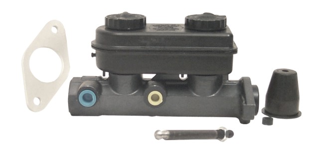

So I have a 71 with factory power disc / drum that I recently upgraded to Wilwood four-piston calipers up front.
Works OK and all - but still use lots of pedal pressure and not getting much 'stop'. Wilwood tells me it should be fine - and I am going to get an adjustable prop valve - but I'm still using the factory master cylinder:
Which I believe has a 1 1/32 bore size.
My thought is an upgrade is needed anyway since the factory one is old, heavy, and probably not giving me the best performance anymore.
I am thinking about upgrading to something like this. with a slightly larger (1 1/8) bore, and obviously lighter weight:
Of course there are tons of options - and I know more bore will increase required pedal pressure, but I have also upgraded to the Wilwoods - so is more volume or more pressure needed?
Anyone school me on what master would be a good upgrade and why?

Master cylinder piston is to large. Go here and do the math. It will tell you all you need to know.
Doug
http://www.markwilliams.com/braketech.aspx

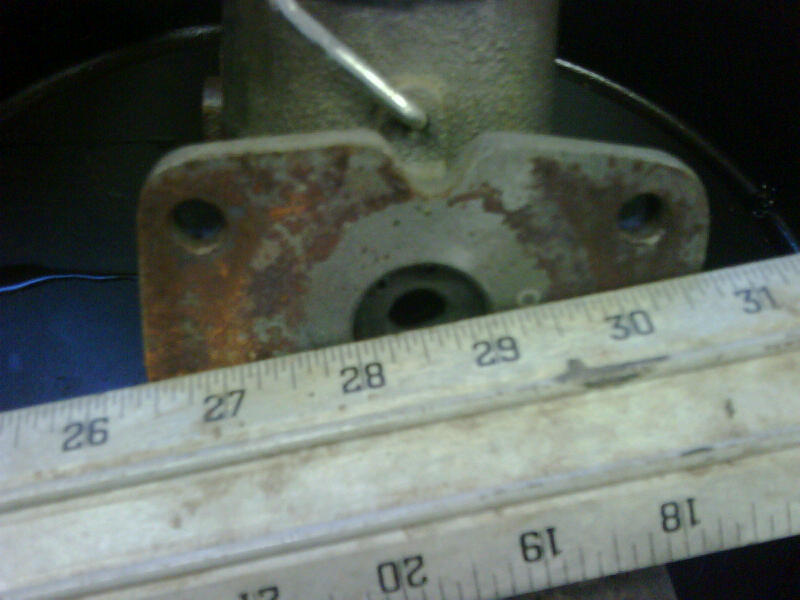

Well,
I pulled the existing master which sure looks like 1 1/32 to me. It sure isn't 1 1/8 and it sure isn't 1.00.
According to Mark Williams calculators - it looks to suggest that a 1.00 master is called for. Not sure how much difference a 32nd of an inch is going to make in the bid scheme of things...
I do also have the 15/16 wheel cylinder in the rears already.
Guess I need to do some calling around and see what else I can find out.
master looks kinda nasty in your pics.when was the last time it was changed?i like to use the master off a 79 dodge pup with manual brakes for most of my convertions.price is much better then the aftermarket masters and still gives great stopping power.looks almost identical to aftermarket master in your pick above.
There is some corrosion on the power booster that I think infected the master where they mate. Probably needs to be changed anyway... maybe's got 10 years on it? Seems like yesterday that I got it, but the mind goes you know...
