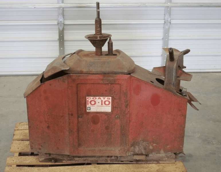

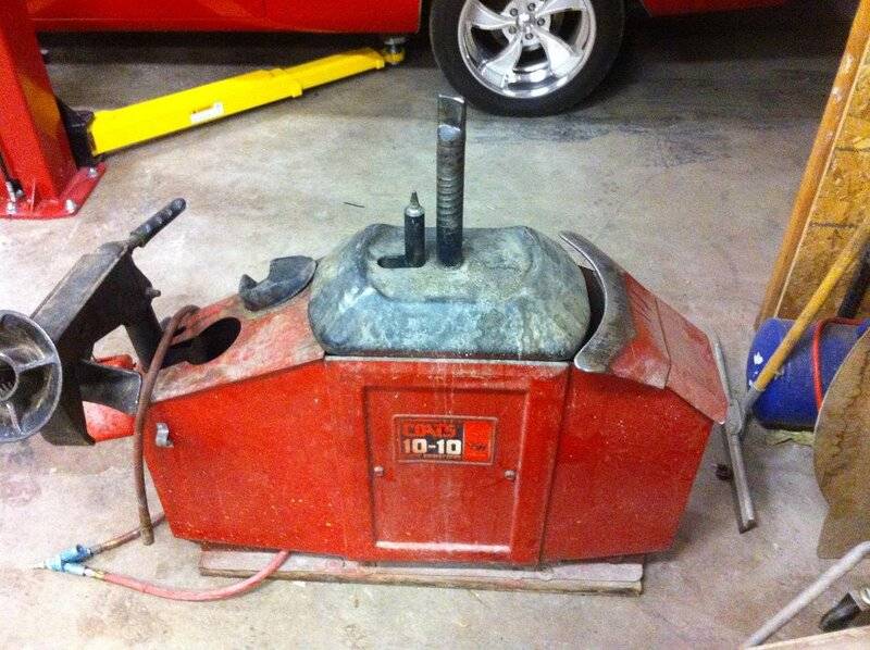

Atlas is the name of everything supplied to Chevron stations... The machine actually appears to be an early Coats 10/10
0
That's the rascal I learned on back in the late 70's. I was lucky that an oldtimer taught me properly on it.Atlas is the name of everything supplied to Chevron stations... The machine actually appears to be an early Coats 10/10View attachment 956647 0

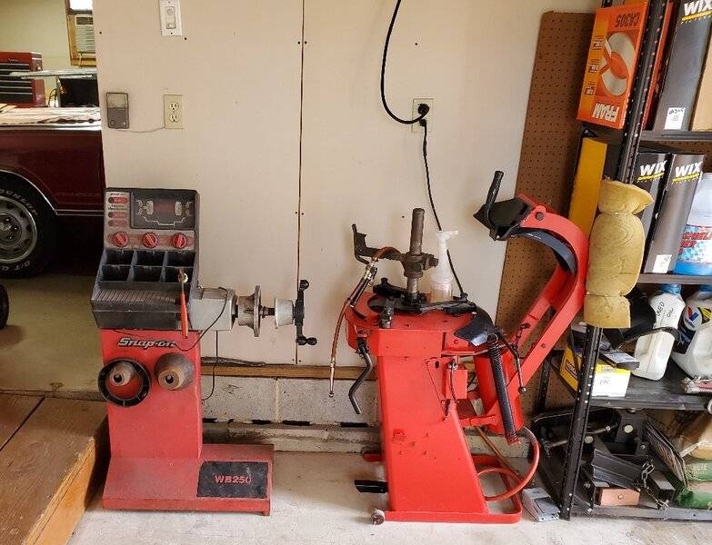

I don't suppose you know anything about servicing them?
As far as I can tell the service routine is either swap the balance head or swap the circuit board. Some machines have knobs to trim the sensors but these don't. Book says to fine balance a wheel before calibration, dunno what skipping that will do to it. Hope not to find out.
Since yours is constantly asking for 2.75 and the calibration weight is 3, thinking the calibration is out, especially if it's consistent. Ya want the pdf?
