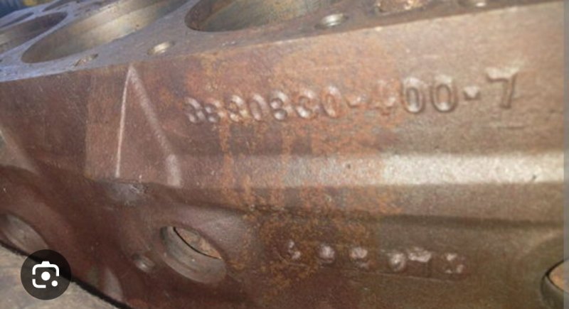

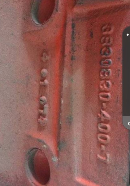

Seems to be a few floating around. Any paint on it yet? I would think a car would be blue, industrial painted orange?
Both of these were orange. Makes me think they were industrial applications.

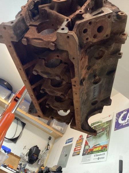

As you can see…. You gotta look hard with your “Mopar Engine Builder” glasses on to see the value in this item. But for a guy that has a 400-block based racing program with the current block in use at +.040 & -.020 at the deck, and nothing in the wings….. this feels pretty good.
I’ll just clean it up , de-rust it as much as possible, and get some paint on the outside. Wire wheel and oil the bores, set it under the bench next to the cars orig. 383 and hopefully forget about it for a long while.
Open to tips on rust removal and storing a block.

It might be worth having it dip-stripped if that is an option nearby to your location. At least it will get a decent flush and probably loosen a lot of internal rust and crud. Oil up well afterwards, and maybe wrap it in plastic....check on the condition periodically.

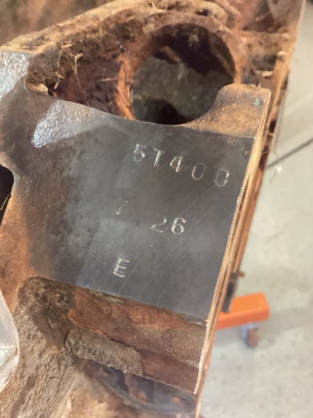

Is there a VIN above the right pan rail? How about numbers by the distributor area?

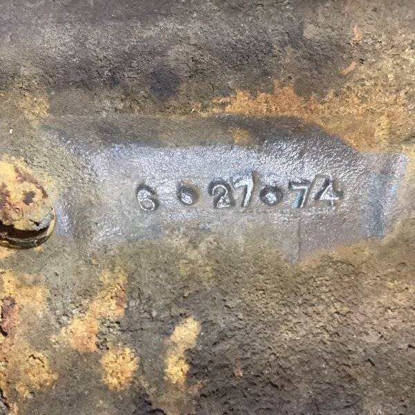

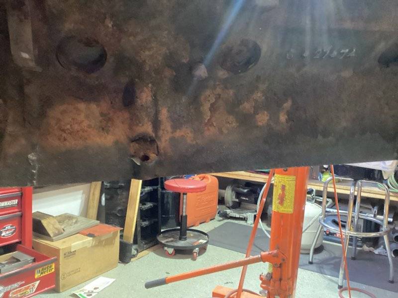

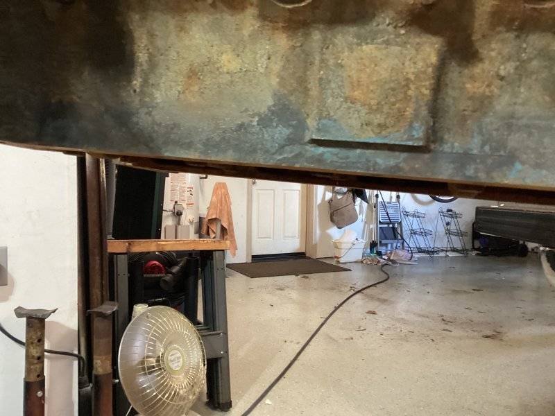

Would not appear to be any stampings above the pan rail at either side. It would seem to have been painted Chrysler blue at some point however.
Distributor pocket is a greasy crusty mess. Not going to get to that today.
the 6-27-74 casting sounds right for the 7-26 assembly date. Blue in color sure makes it seem production.
