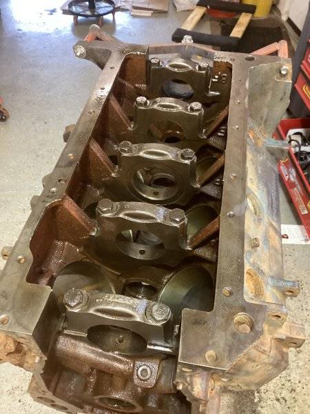

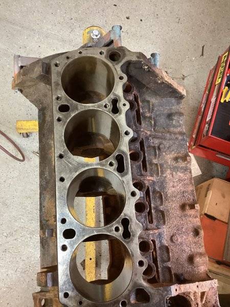

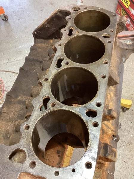

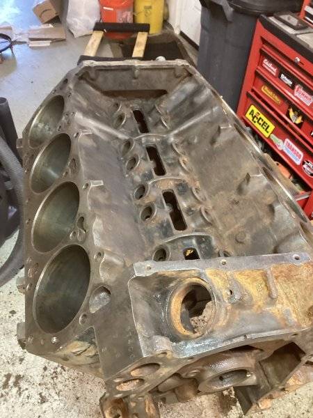

I gave the compressor a workout today, spending much of the day cleaning up this block. The more I saw, the more I smiled! Almost all of the rust was very superficial surface rust, and it came off quickly & easily with a wire wheel. Cylinders are all in great shape; not one single issue in any of them and only a slight ring-ridge. I bet it would clean up at .010. Main caps and saddles all look great. Deck has a couple of spots of scaling, but no major issues at all.

Looks nice. Did the clean up reveal any VIN?

You might get it sonic checked and crack checked now. Just so you know your spare under the bench is good, and doesn't turn out to be junk when you need it.

And having the main caps and not needing a line bore (hopefully) is worth more than you paid for the whole block.
