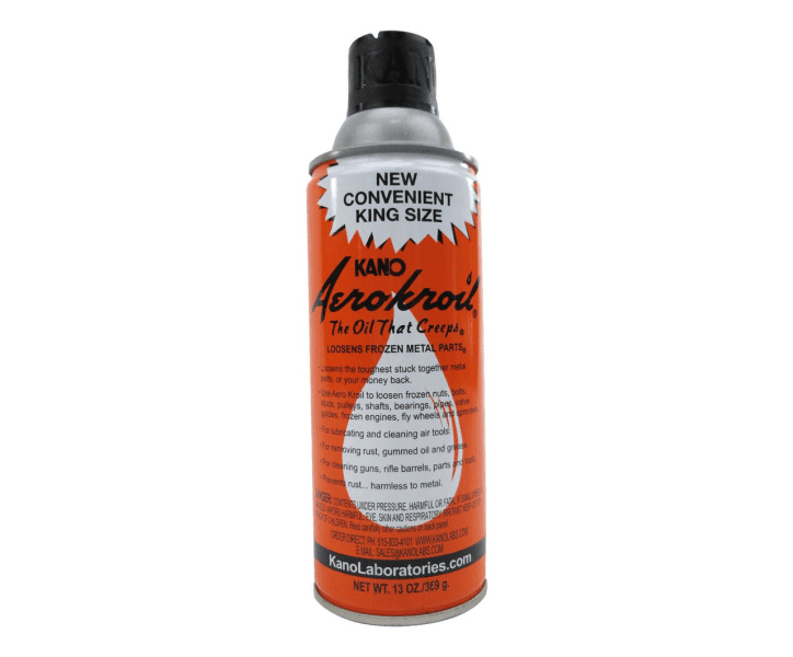

Seafoam Deep Creep + Kroil. Deep creep is a spray and Kroil is a can like the 3-in-1. Time, patience and leverage is the key.
I've never been defeated by this combination (I may have given up but I don't remember.)
I had to go look, but the "deep creep" is what I bought. Kroil has gotten expensive, I have never tried it.

"Kroil"

Kroil is expensive to purchase but cheap to use. I bought an 8 oz can probably 20 years ago and still have plenty left, and I have spilled some of it. I use it literally a couple drops at a time. I just used it (with deep creep) to loosen my lawn mower blades and swap them out for next spring.
