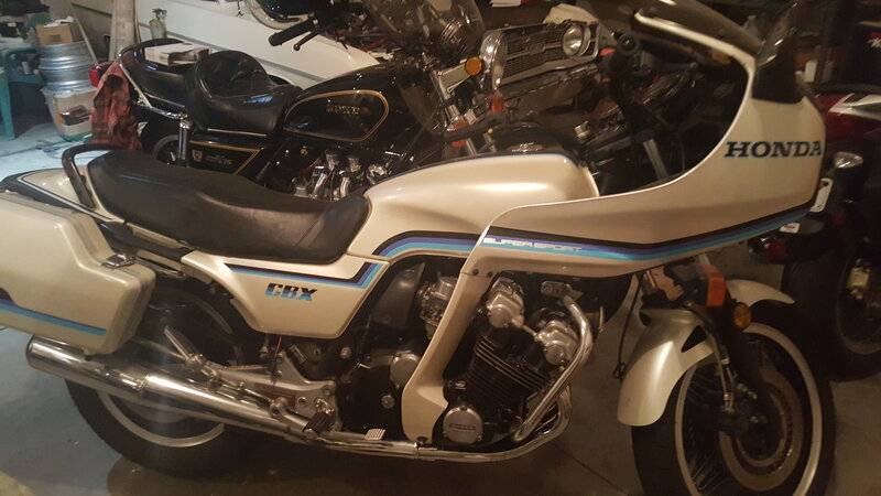

to me the test of all tests was when I winterized my 82 Honda CBX 1000 six cylinder motorcycle. they are notorious for gumming up after sitting just a few months. I had
stored the bike in the garage one October day, and added seafoam to the fuel, ran it until the seafoam was in the carbs, Then shut it down. Then the next spring came, and my business got in the way. the fall came, no time to mess with it. spring again, no time. Then finally in the second year around Halloween, I said that damn bike has to be started!
So, I turned on the fuel, waited for a couple minutes for the fuel to get where it needed to go, and I hit the key. It started within 10 seconds! It Idled, revved up, and was ready to go down the highway!. It ran absolutely the same as when I parked it.
granted I filled it with premium no ethanol when I parked it,, but two years later,, no stutter, no hesitation, and it would raise the front wheel if i was stupid enough to do that.
that was a year ago, now again it is Halloween, and I will be starting it after one year.
I will let everyone know if it is a repeat from last year.
