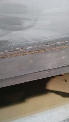

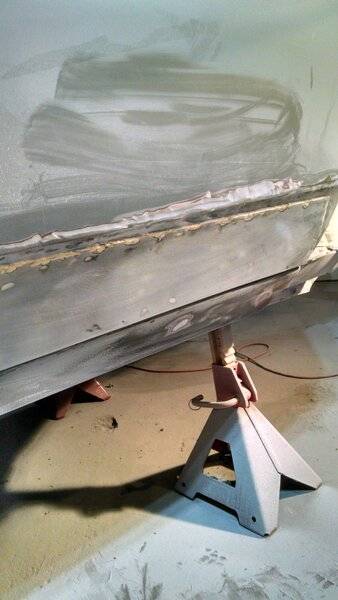

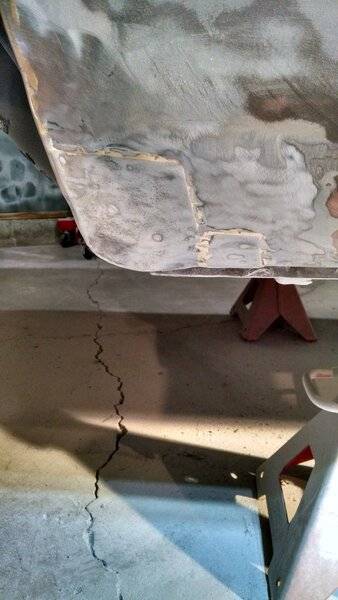

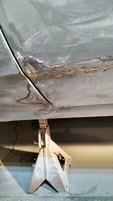

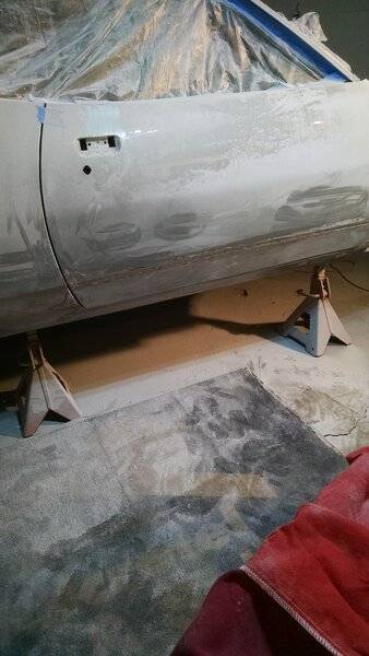

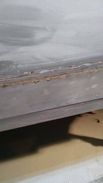

after a couple hours of sanding down the pass door and 1/4 panel and the filler, i found a patch panel on the pass door and front part of the right rear 1/4 panel, is this something a novice body guy can work with, found at least an 1/8 of an inch of filler in some spots, no rust though, what do you guys think?
IMG_20201017_171804043.jpg IMG_20201017_171603591.jpg IMG_20201017_171548300_HDR.jpg IMG_20201017_171559606_HDR.jpg IMG_20201017_171727147_HDR.jpg
Can't tell from the photos, but it looks like those patch panels were braised in.
As for your question; Yes, I think a novice body guy can handle this. Basic bodywork is more about patience and repetition than it is about a great skill set. If you know/learn the basic steps and have the basic tools you can do a very fine job. If you make a mistake you just sand it back down to where you were before and try again. Painting, on the other hand can get messed up pretty quick and that is a lot harder to fix. While you are doing your bodywork you will also be learning how to control your paint gun as you will be spraying a lot of epoxy, primer/filler, and sealer before you actually have to spray color. By that time you should have your gun figured out. So I would not be afraid to start this project. Just take your time, ask a lot of questions, and don't worry too much about mistakes, we all have made them. I am still making them. There is no better reward than saying: "Yeah, I did that!"
Yeah, pictures arent the best, wasnt sure if they were leaded in or they used some type of brass i guess, appreciate the answer builderguy
