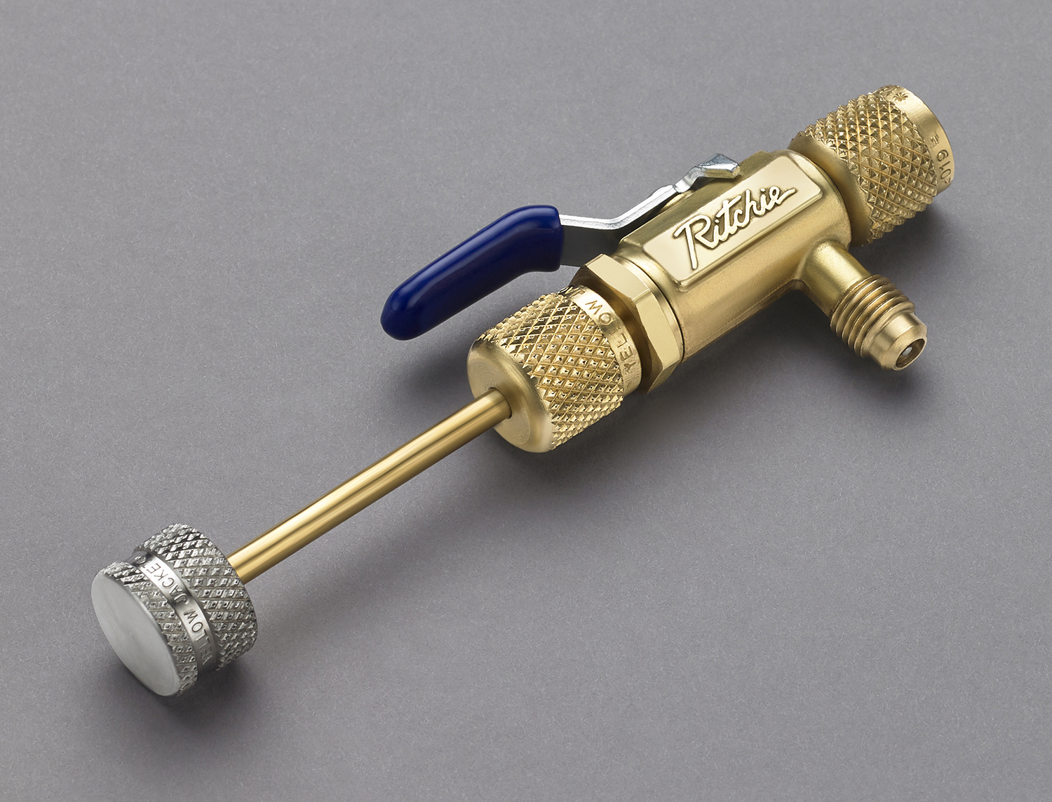

There's a Schrader core replacer tool. Any good commercial HVAC tech will have one. The cap actually should have a copper flare washer under it. Snug up the dryer fitting and see if ti stops leaking.
I can try to tighten the drier up, but I think it’s already cinched well. I kinda worried about leaks with this being my first try and made sure to double check all. I think it’s strange it’s on bath sides of it equally and no other spots show even a hint of dye.
so that’s a Schrader under there? I used to have a tool for tire valves, is it some special version for this?
There are types of these Schrader tools that allow you to change the Schrader without blowing the charge! Not sure if the one pictured is that type or not, I think it is. You can probably buy one at most automotive stores or even Harbor Freight! They are not expensive. Good luck. I used mine a couple of times and it makes easy quick work of the task. A good tool to have on hand! :drinks:

is this d shaped thing what is expected? Will I be able to get the core out or will it have to be completely pulled and changed? I was going to ask the yellow jacket people, but they’ve told me to find a distributor. This is proving harder than it looks and I bet the counter people won’t know.
After several calls I found that I can get a Navac brand with both size tools for 60 bucks. I guess that‘d be a good tool for one or two uses. Appion brand is 82 each size.

Sue??? LOL.. Buy the tool from Amazon & when your done with it give it to the guy at the shop... He'll appreciate it & actually have a use for it... And maybe he'll realize he's not the final word on knowing everything..

You need to find a buddy that does commercial HVAC. Any good mechanic will have a core removal tool.
