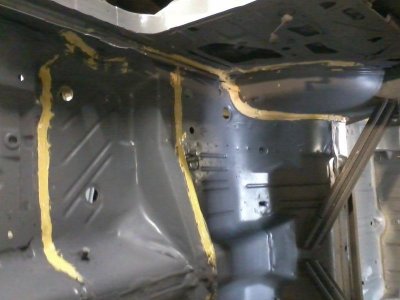

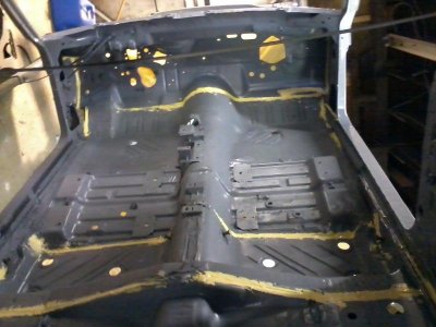

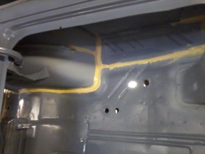

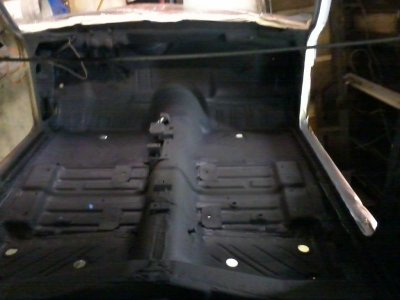

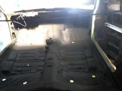

I used Lord Fusor 019 seam sealer. A little pricy, and you need a special cork gun that has a dual action to mix it as it comes out. This stuff is amazing, and easy to work with. I think it was worth the money.
