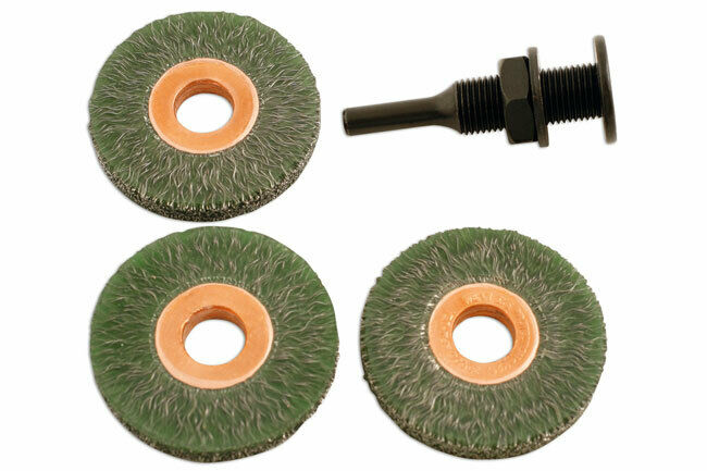

This will probably work, wear gloves and eye protection. I've found them in 2" and 3" diameter. Turn them over when they get a little dull, or find some with a fixed arbor and use a reversible drill.
Mule Skinner Encapsulated Brush
