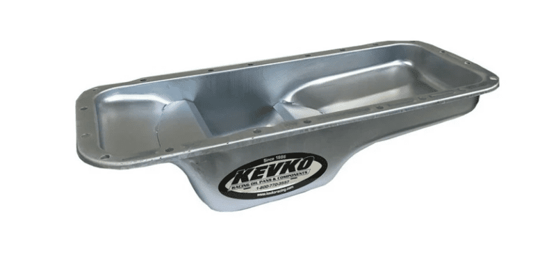

440source got a repro pan, not stamped buy it works as far has been told. Is pretty much the same 971 pan but without the stamping.
They were available with the stamping, BUT dunno why not anymore since some years ago.

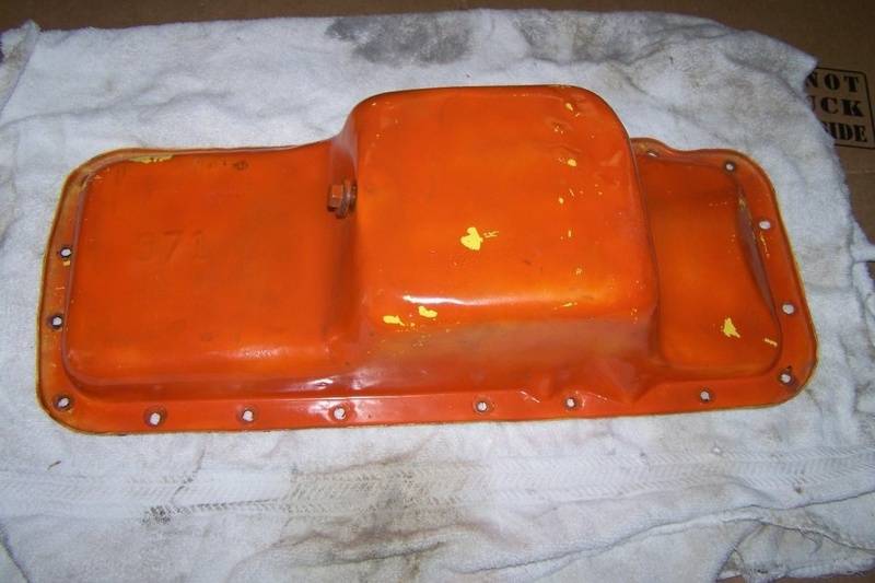

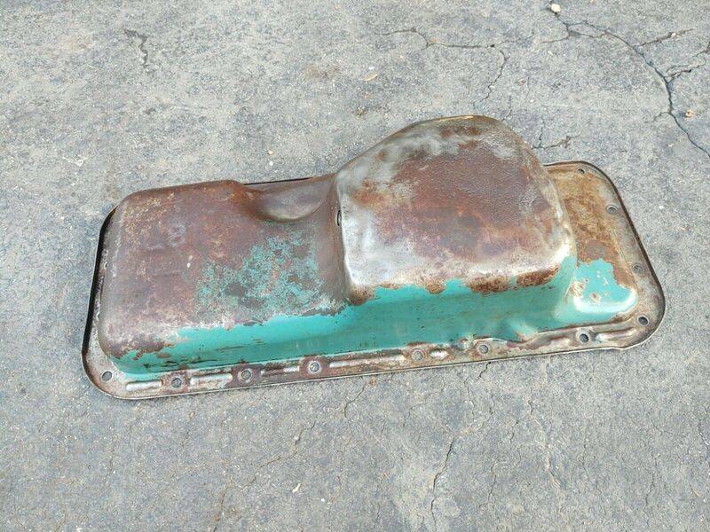

I think the 187 pan is really close to the 971
This is a 187
This is a 971

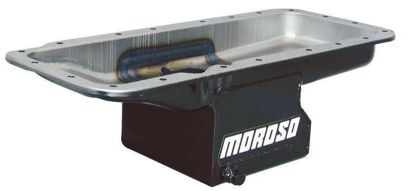

i has bought it, but it only has 5 inch where the Sump begin. I think at the moment there is no standard version available and I need to use modified one, like the Moroso
I've got this pan in my 73 440 runner, and it fits perfectly.
