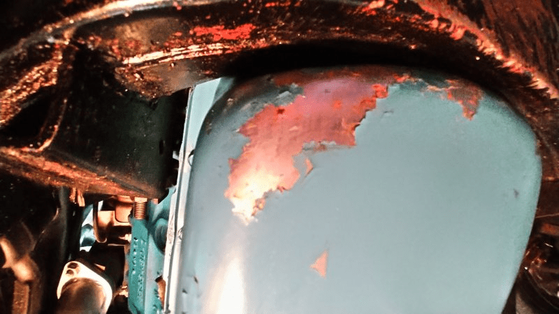

Need to purchase a new big block 917 oil pan for a 74 dodge charger. Vender's sell the early 440 pan. Pan will not clear the newer k-frame. If you have a good source, please advise.

Checked with Source 440 for a 971 pan. No help only stock is the 66-72 big block
Yup, I used the 440 source pan and it fits perfectly.

Checked with 440 Source. Dealer stated his oil pan was for a pre-73 b body. If you have a good part number. I would appreciate the information. Price is not an issue. If it doesn't fit, I will just keep it
Thanks
Well, this is what I used, and like I said it fits great on my 73.
Oil Pan - Center Sump - Plain Steel - 5 Quart-440 Source
