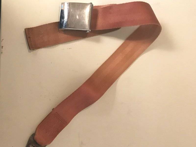

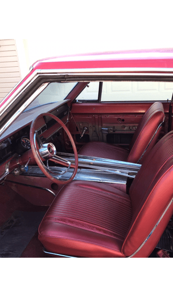

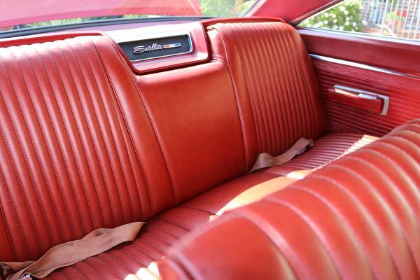

1966 Satellite, bright red interior, belts faded, wanna get the right color and restore them. Mine look like a wine color after cleaning. Are they supposed to be a bit of a contrast, or match the color of the seats? Thought about getting RIT, and they had 3 different shades of red, including wine, at the local Michaels. I got the 66 parts catalog out and found the numbers "0464 AR7" listed under the bucket seat section. Also found an ad from buyamericanmusclecar.com with backseat pic included. The first pic is my belt, my seat color, and the ad from that website. Is that close or we both have bleached out belts? Any help would be appreciated. Thank you.

I attempted the 'RIT' route on a set of black seatbelts (they looked green after cleaning). Never got them totally black, and the color would wipe off onto anything lighter in color.
You can do a search of 'seatbelt restoration' and find multiple services. You can also search for 'seatbelt webbing' and locate various sites that sell it in rolls. You do need to read the description (thickness and width), as newer belts are thinner and a bit narrower.

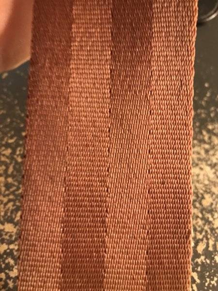

You also need to look at the 'lines' in the belt. Old (your) belts likely have 4 lines in the weave? Late model belt material has more (5 lines?), and they're skinnier, as is the belt itself. 'New' cars have no lines.
I ended up ordering a roll of correct belt material and having a friend (retired Navy 'Parachute Rigger') sew them up.
Good luck!
Thanks Dako! I expected more replies, but we can see that didn't happen. So I'm assuming the seat belts aren't porous, allowing the dye to soak into them. I just found a red seat belt color, which is quite dark, in the 1966 Belvedere sales brochure. Other than that, I haven't found anything online concerning the colors. I'm also assuming this webbing is what you're referring to as far as 4-line weave?IMG_3421.JPG Here are the red belts I was talking about; hard to believe that my belts were that dark at one time. I did see a good post under seatbelt restoration asking for opinions, back in early 2014. Seems SEM spray paint may be the easiest way to go, and someone else mentioned Jacquard dye, which they said may be easier to use than RIT. I just need to find out what color they were supposed to be from the get go. IMG_3429.JPG

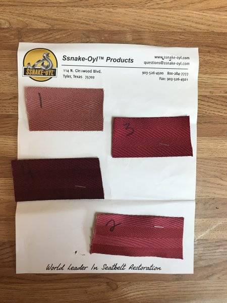

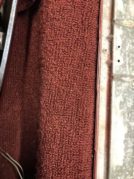

I sent an email to Ssnake Oyl Products this past weekend and Mary has been in touch with me. She said the belts normally match the carpet color. I sent her a pic of my carpet, which is different from the seats. She said it looked like "rust" color! I asked her what the color name is, and she said she would send me 4 color swatches of red. Hopefully I will be receiving some clarity soon.

Surprisingly got the color swatches today. The first one looks closest to what the belts look like now. None of them are a perfect match for the carpet! If the belt color is supposed to match the carpet, has anybody ever seen carpet in color#1?IMG_3464 (1).JPG

No one will know, because there is a good bit of variation Depending on plant of the build, date and even the shift, all can trigger color or part changes - painted buckles vs chrome, contrast or matching webbing. I wouldn't sweat it a bunch.
After 50-60 years your original color won't be the same as it was when it left the factory. Don't expect to find an exact match.
I don't want the belts to match what they are now, just want them to be what they were originally, if possible. So, if you look at the second pic I originally posted, they would probably be something in between the sets and carpet.
Take a seam ripper and cut open the end where the webbing is sewn together around the buckle. Maybe a rear one would fair better. Fair chance it will be less sun-faded. Google up "four-panel 2" webbing. At least i think it's 2".
