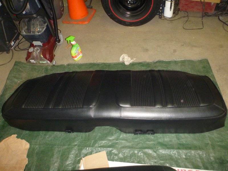

Sorry to resurrect this but does any one have pictures of where these are mounted for the back seat and front buckets?

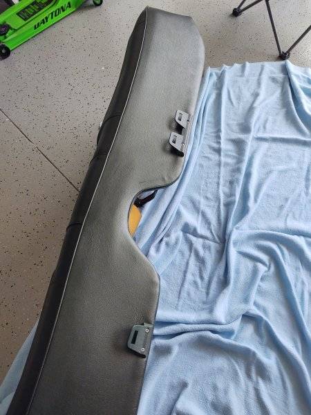

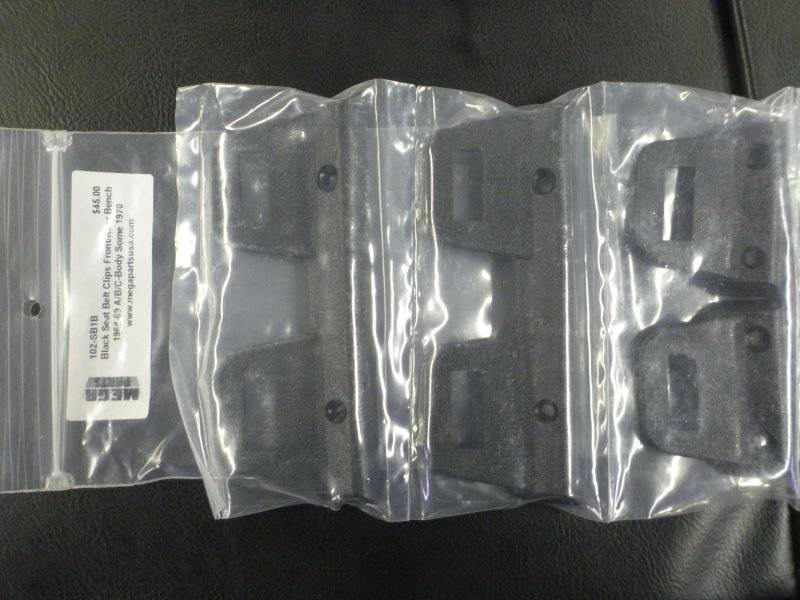

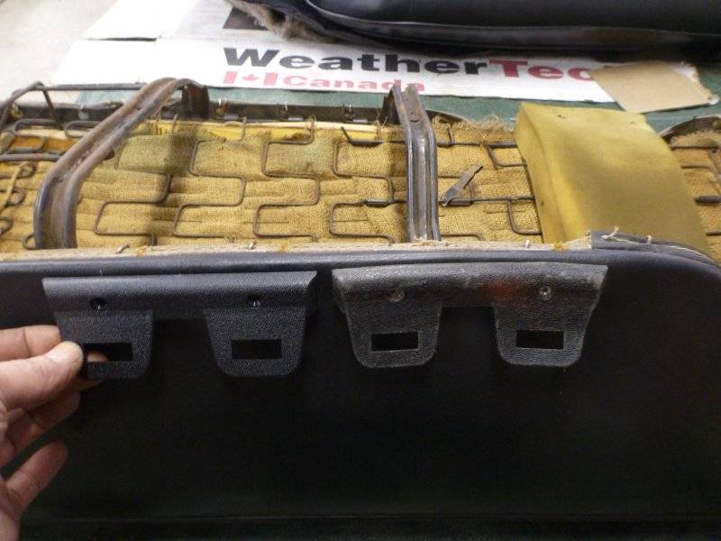

Just added them to my 69 Bee without knowing if they came originally. Tired of the scattered seat belt look.
However, my front belts aren’t long enough to reach the clips without really stretching them out all day, and my size doesn’t require all that belt.

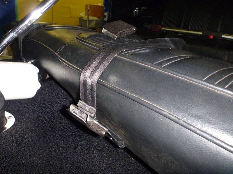

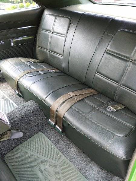

This is the positioning on a '69 Charger.
Run your fingers along the bottom frame (facing front) to see if the original holes are present. Mine were, after a long-ago reupholstering, which covered them.
