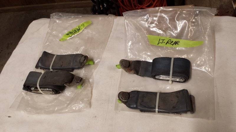

Here is my current conundrum and the main cause of my question.
I have 8 attaching points in the usual places THAT I CAN FIND by sticking my head in the car:
2 each at both rear seats on the axle tunnel.
2 each at both front seats.
( One on each side of the drive shaft tunnel and one each rocker panel.)
That is a total 8 attaching points in the usual places for lap belts.
4 in the rear and 4 in the front.
HOWEVER, I have 12 bolts with matching lap belt straps.
I took them out of the car.
How did this occur?
I have not solved that yet.
But it is very curious.
