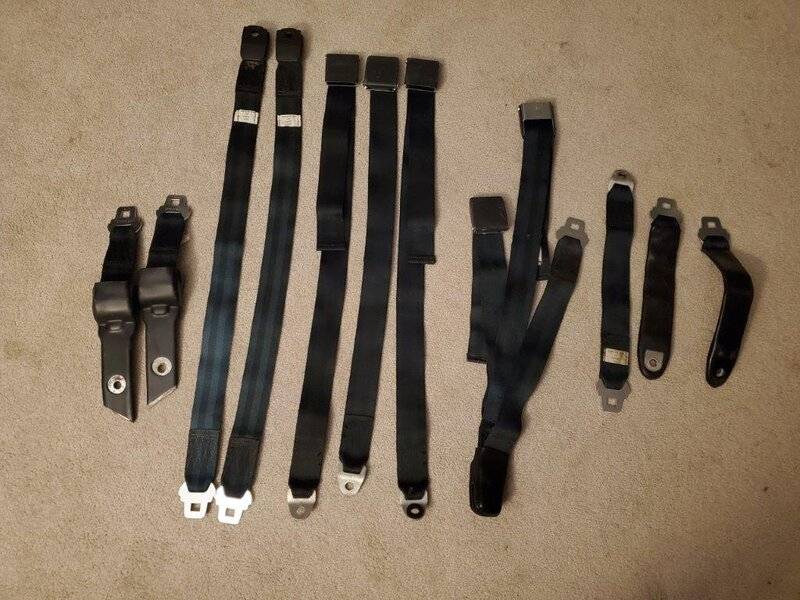

Hey everyone. I cleaned up my belts with simple green and they came out great. However, much of my car came in boxes and I now realize that I seem to be missing some belts. I checked online at some vendors, but came up with different pieces depending. I assume that this is because they used a generic picture. Anyways, I though that I'd ask the experts. Car is a 1970 GTX with bench seat /folding armrest. What am I missing?
I'd say your missing three female back seat belts and the rubber boot to put those three female long belts on the passenger side front (or the drivers side... not sure which one got the male end for the center "buddy")
I am at a loss as to what those two very long belts on the left with male buckles are for. On 1970 vehicles did the shoulder harnesses have male ends? In 1968 and 1969 the shoulder harnesses had female ends. There was a metal male end held to the roof by the sunvisor bolts. The female ends of the shoulder harnesses clipped to those males In order to store the shoulder harnesses were not being used.
Looks to me like you are missing the passenger side - Cross and Lap females + one female for the Buddy seat passenger
:welcome:
I see from the pictures in the link from the last post that The shoulder harnesses did get changed from having female Ends in 1968 and 1969 to having male ends in 1970. There are two bundles with three belts each that bolt on either side of the transmission tunnel. You have one of those, the one that has two female and one male end. One of those females is for the lapbelt the other female is for the shoulder harness and the male is for the middle passenger. What you are missing is another bundle of three belts with all three belts having female ends. From that bundle one will be for the lapbelt one will be for the shoulder harness and the third will be for the middle passenger. Those other three long belts with the female ends are for the backseat.
Looks like KiwiGTX beat me to it
Thank you everyone. Yes, I am missing some of the bolts as well. ****, now to find what I'm missing without buying a whole set. Thanks again guys.
