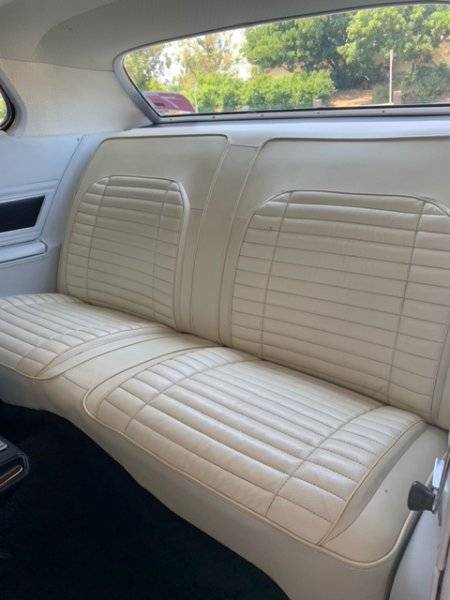

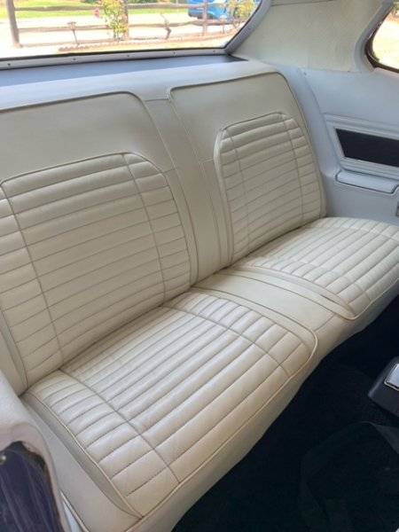

Hello Everyone, I am a fairly new owner of a '71 Roadrunner that was restored years and years ago but it's in great shape. I have added some photos...

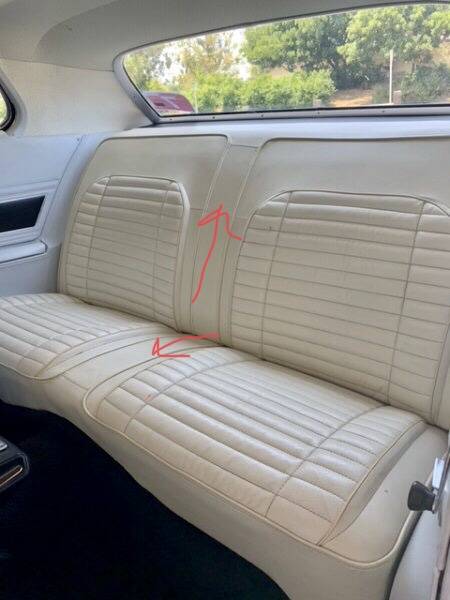

The rear seats did not come with seat belts and I am planning on installing them. Left, middle, and right. I've learned how to remove the bottom part of the rear seat by pushing in and up and therefore disengaging the seat from the clips.
However, I'm not really sure how to remove the back portion of the seat. I can see the partition that sits between the trunk opening and the back of the seat.
My questions is does the back have a trick to remove it also? Do I have to remove the rear passenger side panels? (hopefully not) And also, if anyone has any photos of where the rear seat belts are bolted to the floor, to include a middle seat, that would be awesome. Thanks guys!
~Ritchie
There two metal tabs on the bottom of the seat back that protrude through tabs on the seat then bent over. Straighted them out, pull the seat bottom towards you then slide it up off the upper hangers.
The rear side panels do not need to be removed to take the seat out. Perfect instructions above.:thumbsup: The 2 clips, Pull towards you and up. Great looking car!
Here is what one of the tabs looks like. Right at the bottom of the wheel well.
The rear seat-back in my 71 had 2 steel loops from the inner seat frame that held it down at the seatbelt bolts. I dont know when it changed but assume it was in mid 71 production. Its hard to believe the changes were between assembly plants.
That's the way my rear seat back is in my 71 Plymouth.
Im not sure you even need to remove the seat back to get to the seat belt bolt holes. They’re easy to find, they will be the only threaded holes under the seat, usually very close to where the bottom bun and the seat back meet.
Correct. One on each side at the sill and one each side of the tunnel. The center belts and inner straps share the same bolt locations. Your 71 should have come from the factory with federally mandated seat belts front and rear. They were required in everything 68 and up.
Thanks for instructions T2R9, If I run into any issues, do you mind if I private message you with questions? I won't bug you unless it's crucial! Haha
Thanks mopar 3 B, yeah once I removed the bottom seat, I could barely see what I believe to be the seat belt holes, but they were much higher up the floor like you said near the tunnel... A few folks have said on this thread that I may not need to even remove the back of the seat, but I guess I wanted to make sure I was using the right holes and I wanted to really clear view of what I'm looking at. But I'm stoked now with all the quick info I got, I'm ready to get to work!! I have most of the belts, still waiting for one to come in the mail...
