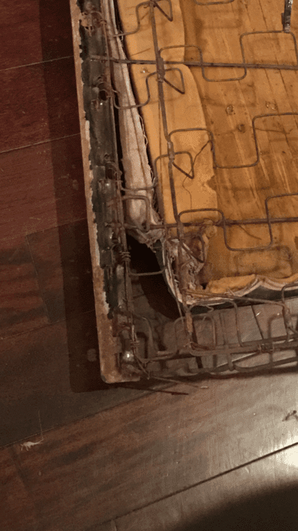

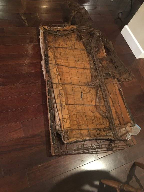

In the process of removing all the hog rings, fabric, and muslin from my seats.
After I get the frames/springs sand blasted, should I paint them with a rattle-can or powder coat them?
Black will be the color.
Taking into account costs and durability.
Thanks!!!

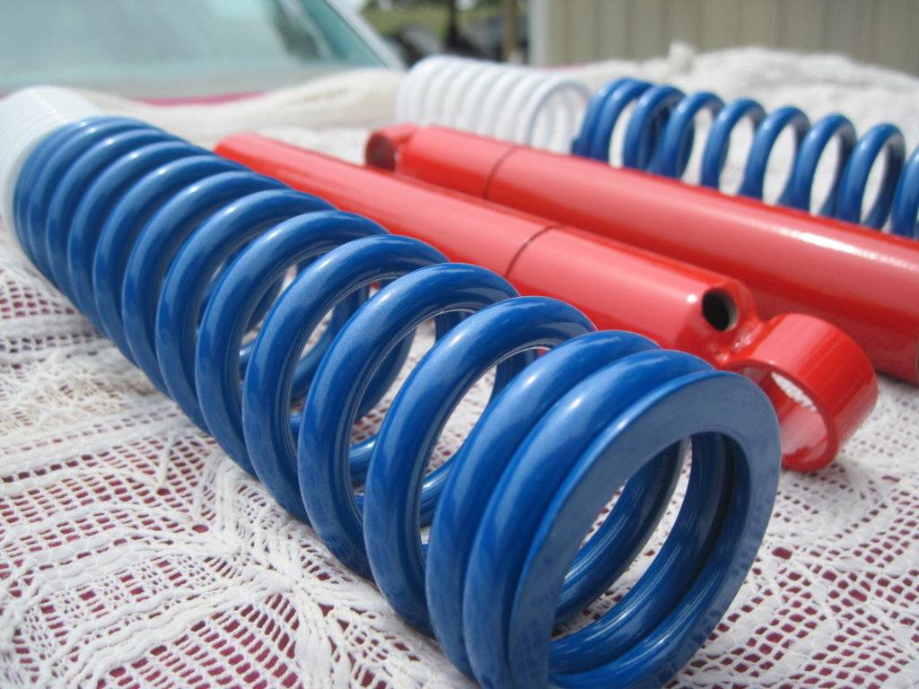

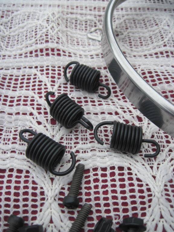

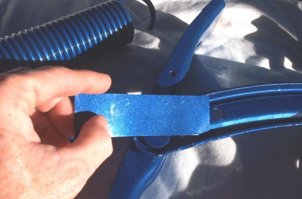

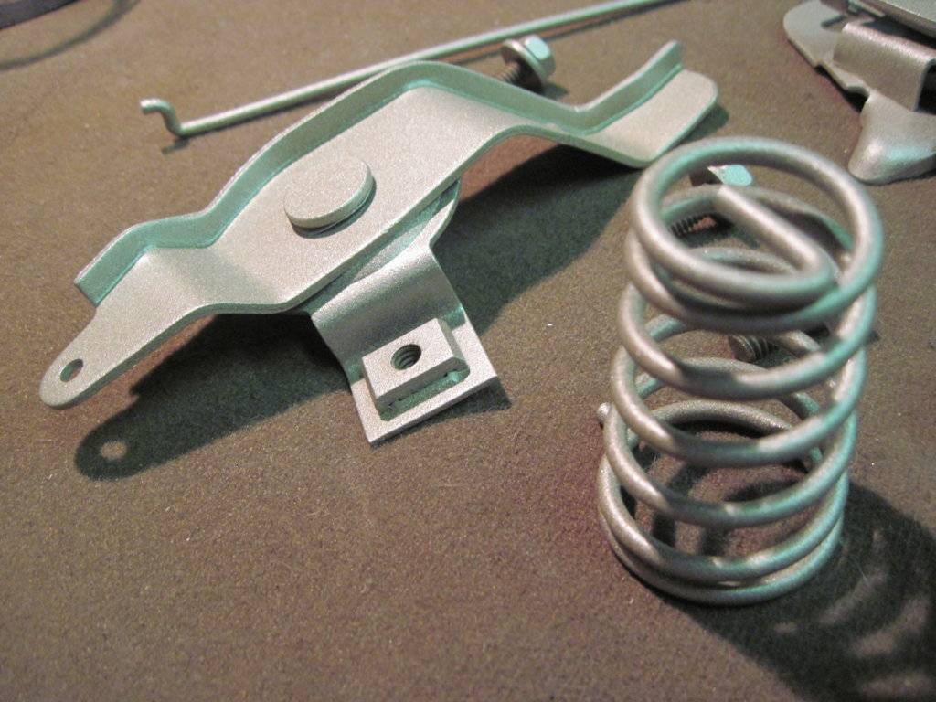

Actually, powder is MORE flexible than paint. I've had great luck powder coating springs of various types from hood springs all the way down to tiny headlight adjusting springs with no issues or customer complaints (even many years later).
In this case though, I'd be inclined to agree with the scuff-and-spray bomb advice. The amount of prep work you'll need versus the benefits gained is not really a good ratio, especially considering that it will most likely never be subjected to the elements or excessive moisture.

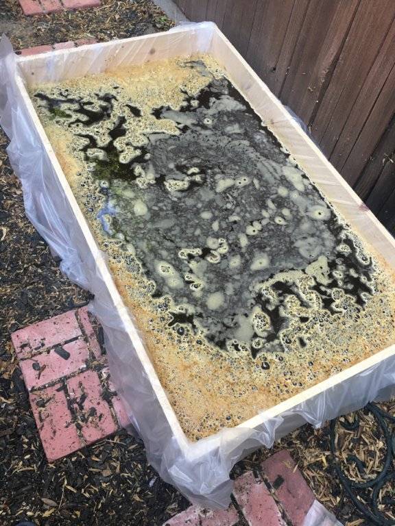

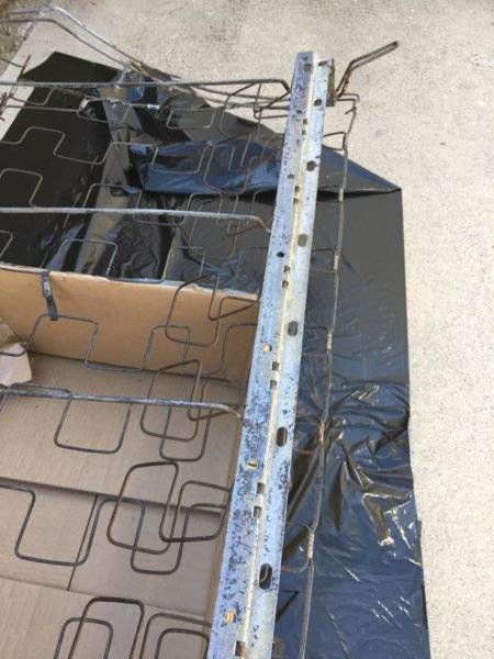

I could write my own blog on this mini-project. I just went out and bought a 5 gallon container of molasses from a livestock feed store (wow, the women at the store were cute. It must be something about riding horses), and 2 qts of POR-15. A friend at work had some left over plastic she gave to me, and now I need to build a tub frame so the spring frames can soak in a 15-1 mixture for a week.

The big reveal will be this weekend! I can tell something is happening by the film that has appeared on the surface. This is an early shot.

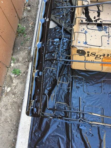

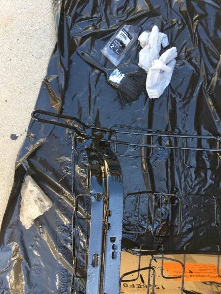

Here are the results. Came out of the brew, and easily power washed off the black residue and the remaining paint. Pre-treated with a POR-15 metal prep, and then next day when completely dry, POR-15 paint! On to the next half.
