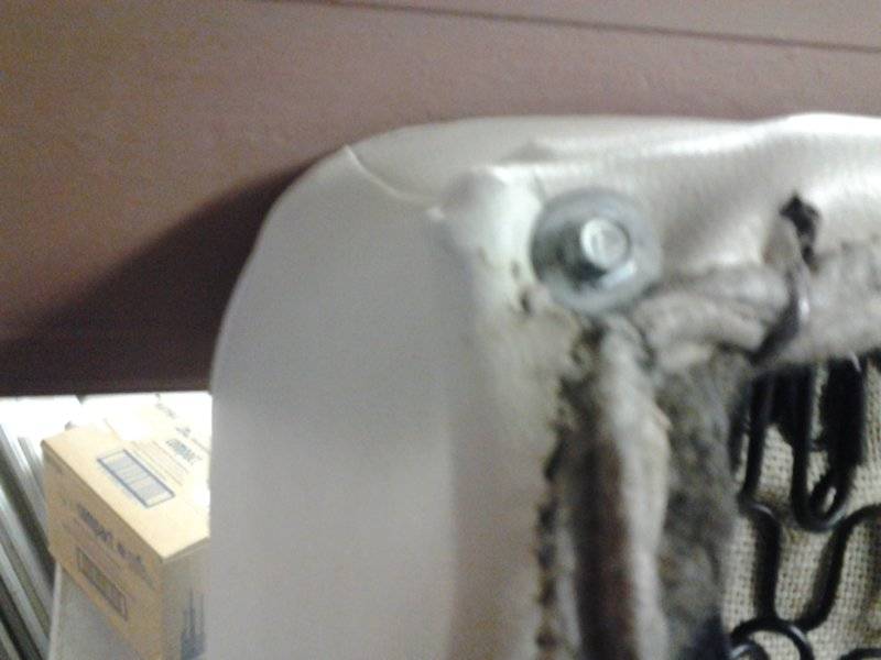

I was installing a set of Legendary seat covers for my friends 70 V code GTX, and it took me over three hours to get the bottom of the rear seat cover on. I don't know if Legendary cuts them to the exact milimeter,or if the rear seat frame was tweaked, but I couldn't pull enough material to get the bottom left hand corner to fit. It started to tear the material of the cover! In the back edge of the seat cover there was just enough material to get the rear corners over the frame, and meet the rear edge of the seat frame. Anyone else run into this issue. The top part of the rear seat fit fine, which was good because it has the embossed Plymouth design on the top of the seat. A little time out in the sun,and they will look great!
Is it the old batting underneath?
Yes,it was original batting material, but I replaced the burlap. It was not any thicker than the original burlap. I ended up using a zip screw with a small fender washer to hold the material in that corner because the edging that is normally used to attach the hog rings to had pulled away from the vynal from pulling on it. I will paint the screw and washer white so it will not be noticed.
