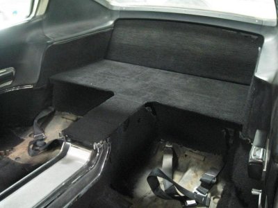

You could do what Prop did to prep the fabric but instead of RIT dye you could use SEM Color Coat. It's for plastic, fabric etc. I sprayed my carpet and rear seats with it last winter. Made old shitty carpet look new.
Before
After
I have just one seatbelt that is faded out of my entire set, and was going to try the SEM option, is that just a standard Black that you used Gpuller?
They make a few different blacks. Used satin black on the seats, that only comes in spray cans. That matched the new Legendary front covers. I got Landau black for the carpet because they sell it in quarts. From what I can tell the Landau is a higher gloss. On seat belts it won't matter.
