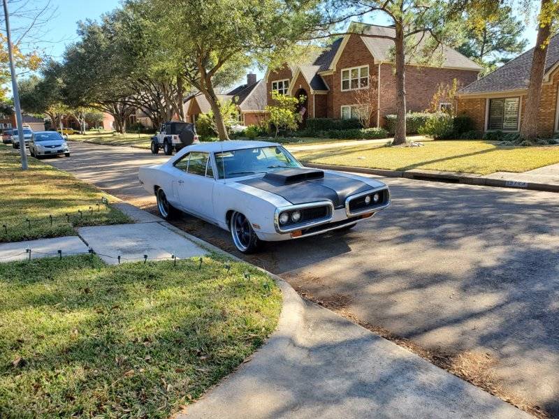

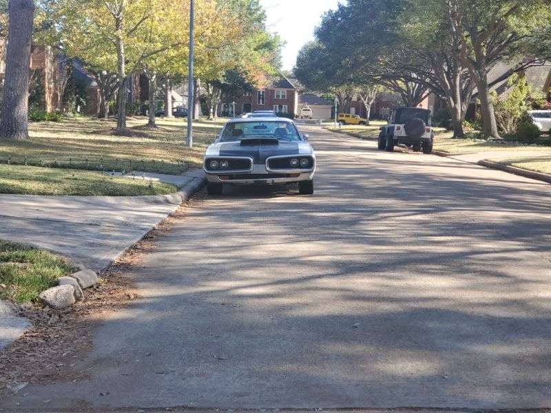

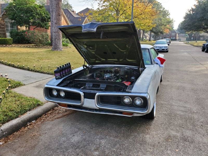

Alright guys I'm up and running!!!! That knock was either a trans mount or a motor mount that is broken, ill have to get a new one. I have been building this car for 2 years almost every chance i could get time for it, never imagined how fun it would be to just cruise through my neighborhood on Christmas day for the first time. Thanks guys I appreciate it! The fluid did the trick :thumbsup: Merry Christmas
Mason now that you took it for a spin time for you to spin around the car with your camera and send us some pics. Great to see you have it going
Ill send y'all pictures real quick, just have to find out how to post them. Definitely the best Christmas ever.
