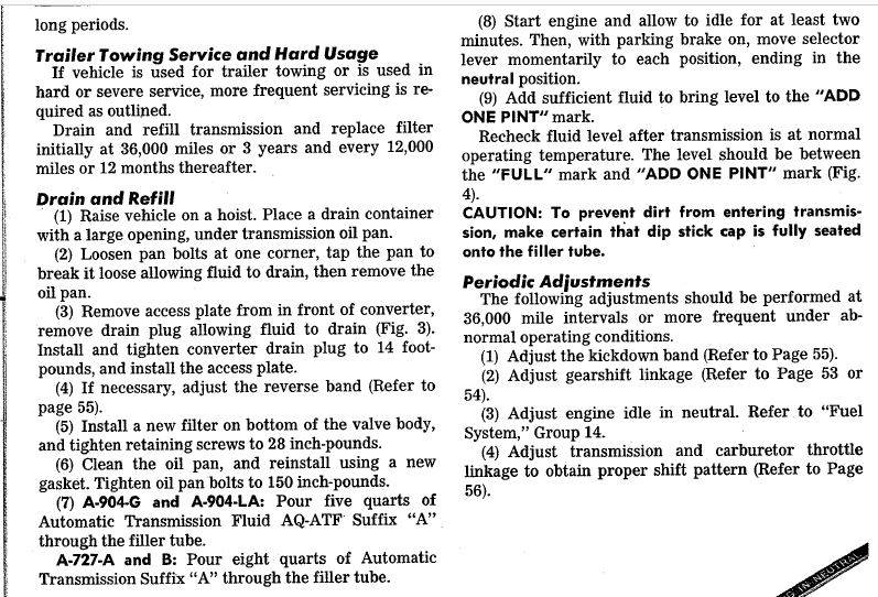

Stock 727 & converter capacity is approximately 9 1/2 quarts. Five is way low resulting in the conditions described. I always start at 8 with my deep pan & add to get around 10-11+. Stock 727 start at 6-7 & add in neutral. I start a little low so not to aerate before the converter fills & move through the gears several times.
This is out of a 66 service manual.
So, there you are. It's at LEAST 3+ quarts low. I'm surprised it even moved! Just hope you didn't fry anything in trying to make it move. It's always a good thing to not try to make something move by giving it more throttle. If it's not moving like it should with light throttle, find out why so that you don't damage things. Good luck.

Fran, thanks for the post. A point of explanation for my method vs the FSM, I found with a stock pan starting with 8 Qts got the level well above the "1 pint low" mark. So I start a bit less & add after starting the engine, then going through the gears adding slowly as it fills everything, so as to avoid the aeration that can really screw things up. The OP's problem was clearly a far low ATF condition. Hopefully not enough running time to do any damage. 727's are really tough & take lots of abuse.

OK, but according to FSM which to my reading says fluid capacity is 18 1/2 Piints including empty converter. Agree drain & fill leaves about 2 +/- Qts in the converter. Just say'in.
