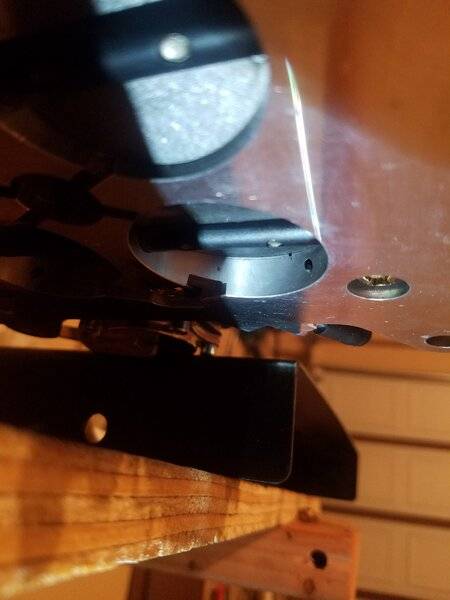

The transition slot was around .030 exposed when I reset it. Here's what it looked like.
OK, yeah that transition slot looks ok.

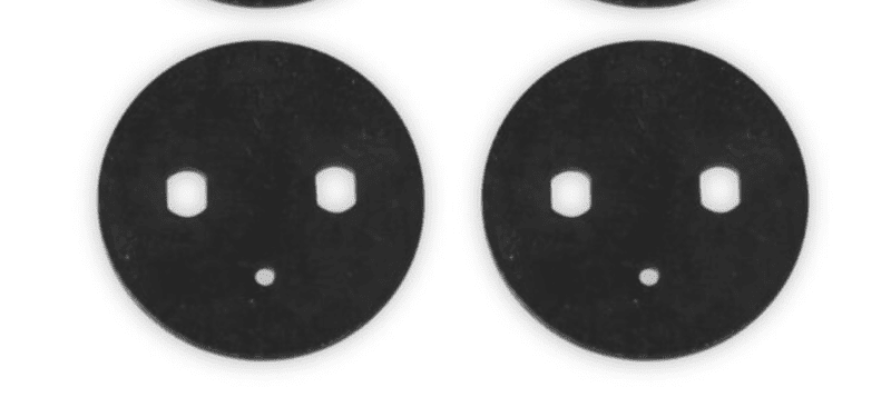

-Drill holes in the primary throttle plates. I did try this and it does introduce extra air. The benefit of this over opening the secondaries is that this by-pass air is mixed directly with the normal air/fuel mixture and stabilizes the A/F to equal over all cylinders.
You hook up the PCV as normal, drill 1 hole in each throttle plate, start small (1/32 or 3/64 drill bit) and increase the hole size until you got that same good idle quality and rpm.
Drill the hole near the middle of the plate, on the same side of the shaft as the transition slot (forward) and make a very small chamfer on the hole.
Like below example.
You should have 1-9/16" throttle plates, Holley/QF sells sets of new throttle plates for around $15 so if you end up with too big holes you have an easy solution of restoring it to normal.
When replacing throttle plates strictly follow the instructions, its not hard but needs to be done right.
