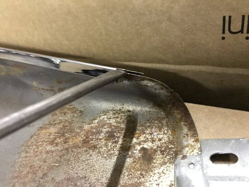

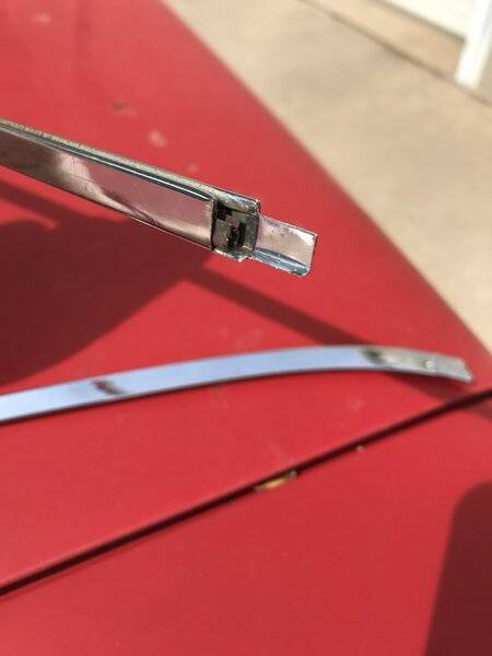

Each side has these 4 clips that can slide inside the chrome, evenly spaced. I slid this one to the end for the picture. They grip into the steel, and it seems to take more than a gentle effort to get them to release. I pushed on mine from the inside edge and once I got them started it wasn't to difficult.
So the clips stay inside the chrome trim and not on the seat back? I’m not clear on how you got them to release off the seat. I tried using a block of wood laid against the outside edge of the trim and small hammer to rap the wood in an effort to knock them off the seat but that didn’t do much. Are the teeth in the clips gripping the inside surface of the back?
Both the inside and outside surfaces. I think I started at the top with a wide blade screwdriver, it's been a couple months.

Well, I'm not having any luck. My clips seem to be locked into a notch cut in the edge of the seat back metal from what little I can see and I can't get them to budge without doing harm to the chrome. Did you use any sort of thin blade tool to ease their grip off of the metal or just pry with your fingers?
I started with a wide flat screwdriver, and while pulling with my fingers, gave the driver a twist. Go easy, you're just trying to add a little pressure while pulling with your fingers.

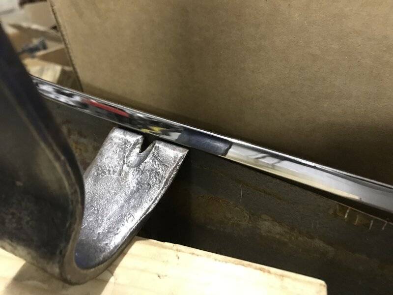

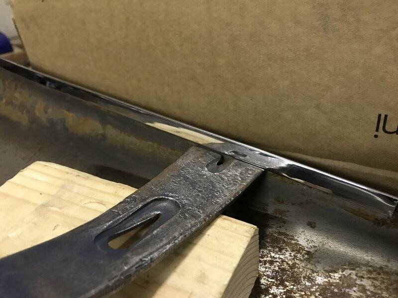

Next I started with a nail-puller and a scrap 2x4, prying from the inside and pulling with my fingers on the outside. If the molding seems to be bending, move down until you're at one of the clips. Remember you're trying to add a little pressure, not pulling nails out of oak. I like the nail-puller because it's wide and spreads out the pressure. Add some tape to the tip of the puller if you're worried about leaving marks, but this is on the inside so shouldn't be seen.
I guess you could try to work a palette knife in the sides to try to loosen the clips, but I didn't need to.

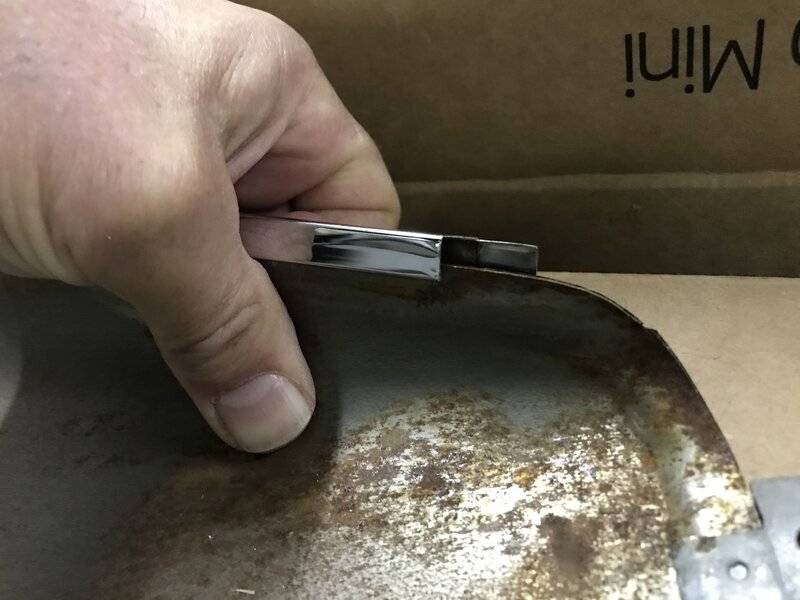

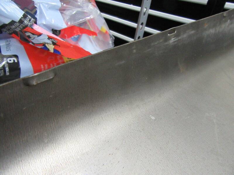

OK - I finally got them off from a different direction. I see now that what you termed clips are 4 louvers like deformations punched in the edge of the seat back shell that alternate side to side and the lip of the trim catches on. I mis understood, thinking they were separate clips.
I started at the bottom where the little end piece is held to the chrome strip by a punched in divot that fits in a hole in the end piece shank. I gently pried on the inside end of the trim around the divot to spread it apart until it disengaged from the trim and could be pulled out. Spreading the inside edge of the trim gets it over the shell deformation at the curved bottom area. Taking a small block of wood and small hammer I then tapped it up and off the top of the shell. After it got past the second deformation it basically just slid/pulled off.

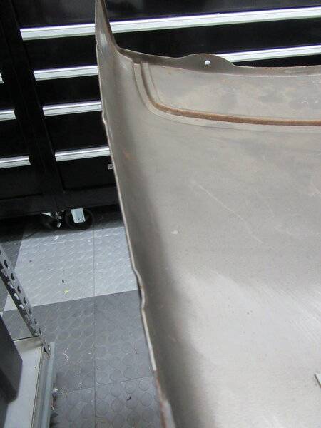

Can you post a picture of the seat back edge? Yours sounds different than what I have, mine is basically flat.
Here is the side of the seat back.

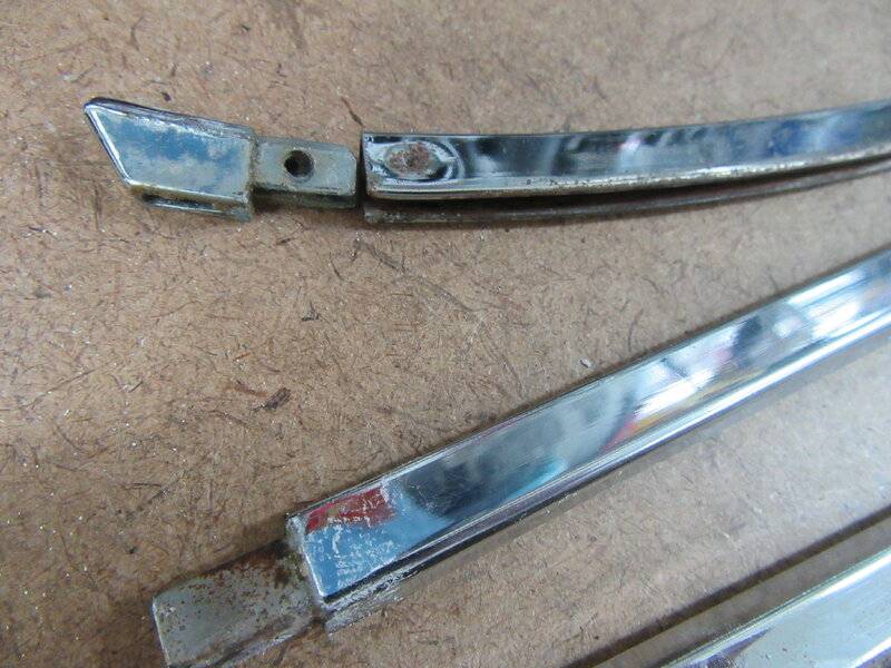

Here is the end piece that I first removed so that the trim could be slid off the back from bottom to top.
Your trim piece looks the same as what I have but the attachment method is definitely different. Good you were able to get it removed without any damage. Learn something new about these cars every day.
