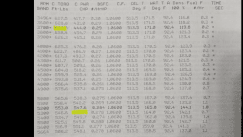

The engine was on a dyno:

Seeing the dyno sheet, that looks like a great street motor. I would leave it alone and put it in the car.
The engine has 10.31:1 static CR.

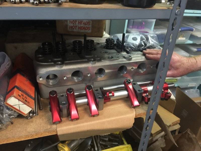

Got my cam & lifters with an assembled head & push rods and drove the Charger (nearly 200 mi-one way) to Rocker Arms Unlimited in Redding.
Cam specs are basically:
Single pattern
114 LSA (110 intake, 118 exhaust)
274* adv dur @ .015
I don't know dur @ .050, but it has 'Winfield' lobes, so...?
.533 lift after lash.

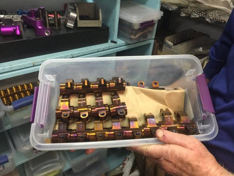

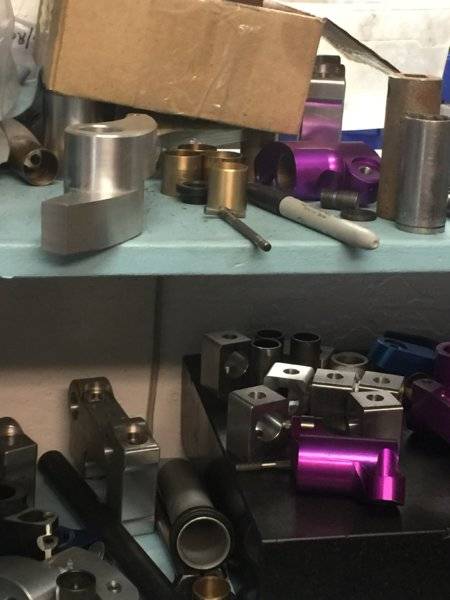

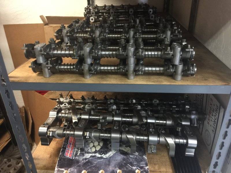

Gary at Rocker Arms unlimited is a great guy!
He answered tons of questions & gave me tour of his shop. They can (and DO) make rocker arms for anything.

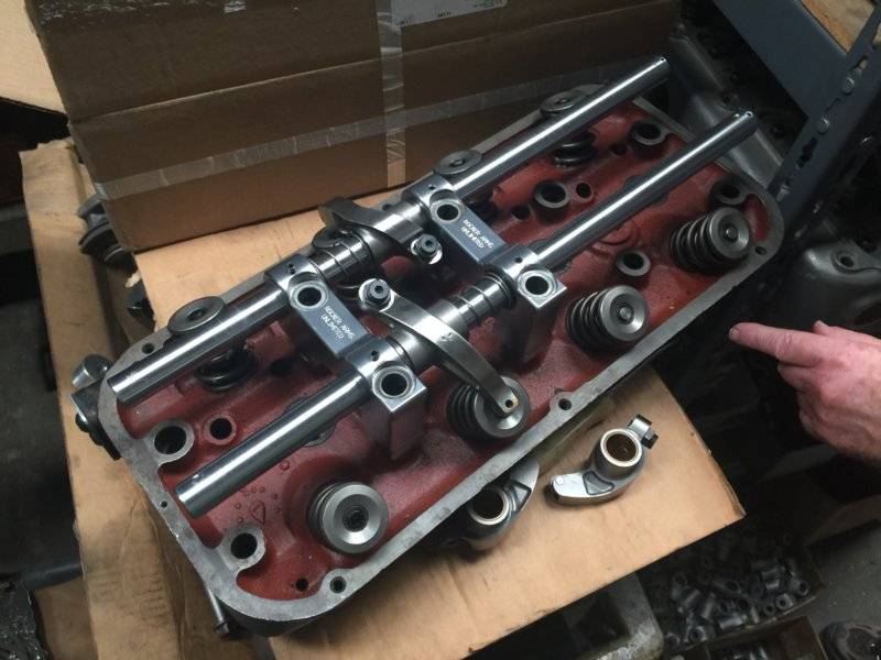

Some for Gene Adams' 392 HEMI, with 1150# springs
Model 'B' Ford
Some HEMI sets ready to send out
Some for 440s

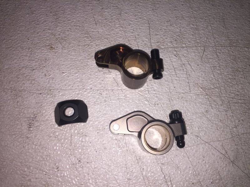

And what mine will look like

Those will be nice rocker arms. Simple engineering criteria suggests that those are better designed than many others.
