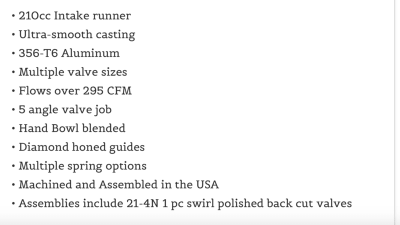

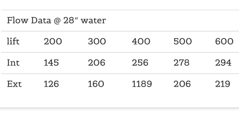

Heads are Promaxx with some more bowl work, cc'd & port matched to intake. I realize that these will limit max output numbers, but they will work for what I am after for now.
