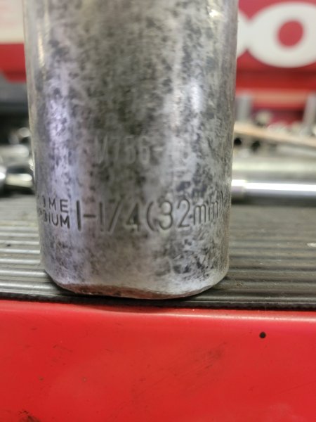

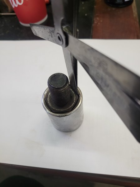

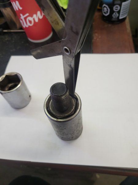

I bought a 70 Satellite Sebring with a seized engine. I put a mixture of ATF and Marvel mystery oil in each cylinder. I want to get a socket on the main bolt in the front to rock the engine with some leverage to get it loose. I can't find the right size socket. I tried 1 and 1/16 and 1 and 1/8 and both were too small. I also have a 32mm socket which was too big. How can I find out what size that bolt head is?

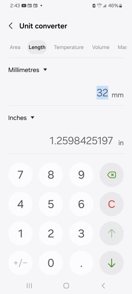

I'm seeing about 45 thou on the 1 1/4, and about 50 on the 32.
This above and/or how worn it is. Trying to break that thing loose, not gonna work most likely
I'm afraid you're right, but hope springs eternal that those extra 10,000ths might make the difference. Otherwise I gotta save my pennies for a new engine.
