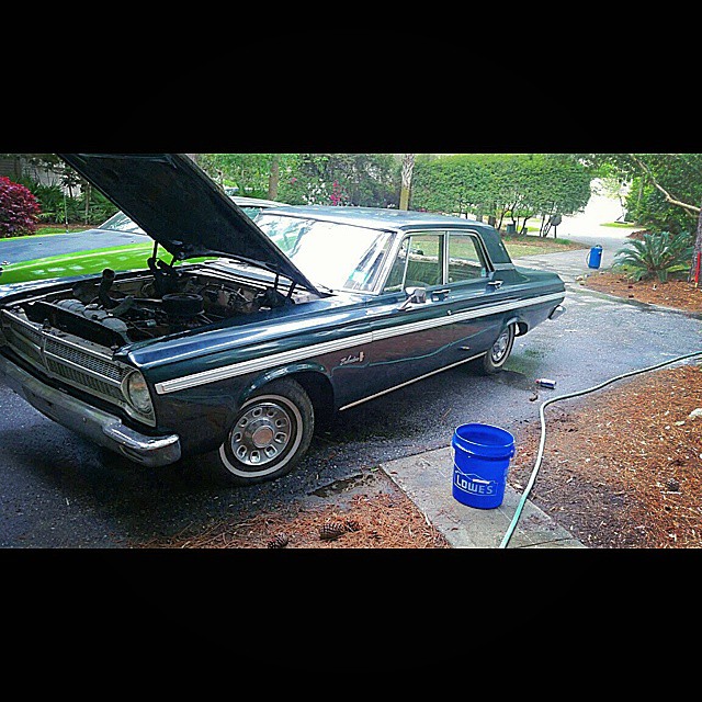

Hey guys, first post for B Bodies Only, I recently bought a 1965 Plymouth Belvedere II. It was quite the barn find, it only has 62k miles on it and everything on it is original, all the VINs match etc. However, it is going to need a full restoration. I have made great progress with the interior, but I have run into a brick wall so to speak. My engine is seized, not sure where I haven't gotten through the whole tear down yet, but it is going to be a serious pain. Anyway what I'm asking you guys is it worth restoring the engine, for the sake of originality or should I just swap another one in? Mind you I'm a 20 year old college student, who barely has a budget for parts and I do all of the work myself. So time and money are of the essence. I really haven't decided whether I am just going to flip the car or keep it. Is it worth the time and money to restore the engine? Thanks for your time.

It is a four door. It is also immaculate condition zero frame rust, the body rust and very minimal floor pan rust, this car is almost perfect, and the paint job is also in fantastic condition. I also ran the VIN and it is a retired detectives car from Virginia. I figured as far as collecting goes and all original 50 year old detectives car with only 62,000 miles on it might go for a pretty buck. The engine is actually seized. The starter was making contact with the flywheel, and just to make sure I took it to a local auto shop and had the starter tested.. it was working perfectly. Then I put a tire iron down on to the flywheel to see if i could get it to crank that way, there really weren't any leverage points. So finally, I removed the radiator and fan to get to the crank pulley. Strangely there was no center bolt on the crank pulley to twist. There are 3 bolts on the front of the crank pulley, I backed them out and used a tire iron on a metal rod to turn the crank pulley, in short it bent the tire iron which I have never seen before. The engine is most definitely seized. I even sprayed PB blaster through the spark plug holes into the cylinders, and still no dice. It is in the best condition that I have ever seen for a 50 year old barn find. If I end up having to swap a new engine in I would love to shoot for a 360 or 383. It has an 8 and 3/4 Posi rear end and a 391 gear, if I am going to spend the money on a different engine I figure go big or go home. Besides I would love to give my brother, AKA Mopar-Charger, some good competition. This is the first mopar I have owned, but I have been surrounded by the greats my whole life. belvedere.jpgbelvedere rear.jpg

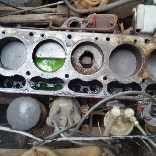

Is this what you mean by a rusted pile of Sh... junk? Or do you guys think I can put new pistons in, hone, and bore it? I have access to a machine shop, so it wouldn't cost me anything.belvedere engine block.jpg

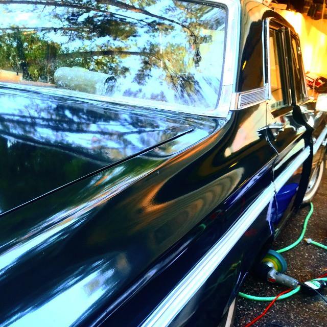

Here is a picture of the cleanliness, and shine of this car.
Wow, talk about opposites. As nice as the car itself is, the engine is the polar opposite.
I'm sure other engine experts will chime in, but as soon as you start tearing the engine down you will then need to buy gaskets, pistons & rings, bearings and on and on and before you know it you will be doing a complete rebuild. I believe you are far likely to have much more in that rebuild than if you find a cheap donor engine.

I'd say slap a new set of pistons and hone it probably bearings too looks like it got stuck someone was trying to free it up by beating that piston with a hammer beings it was closers to the top I'm shure once you free it it will be a good motor the other pistons look new still . Good luck ,
