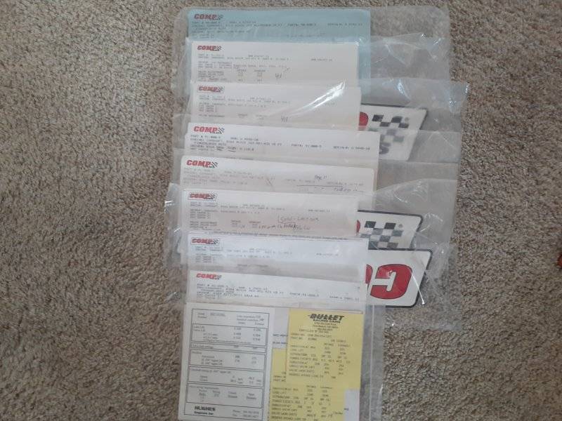

i would go with the 440 source, engine masters tested them and like them the best for the street. you can always unshroud around the valves to get more chamber cc's. stock mopar hp cam has the right duration but it's on a too wide 115 lsa. 208-208 duration is 2 sizes smaller then the stock mopar hp cam. keep the intake between 216 and 220 and the exhaust no bigger than 224 and the lsa between 109-111 and you won't be sorry. below is about half the cams i have used, never keep the cam cards from the earlier mopar 440 built from direct connection lunati and hughes cams.
Thanks, that is some great info.
