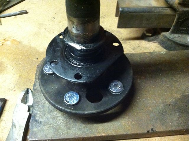

So I set about getting it installed this week. Axles came out with no problems at all - after a few minutes of "not getting it". The service manual says to use the hole in the axle flange to access the axle bearing hold-down bolts. IT'S THE BIGGER OF THE HOLES IN THE FLANGE! YOU SEE, THEY'RE NOT ALL THE SAME SIZE! While I was in there I decided to change out the bearings. the car has 50,000 miles and is 40 years old after all. Dr. Diff sold me the proper Green Bearings for the replacement. With all the debate about Green vs. Timken, I figured if they came from him, they were good enough for me. Read on in the service manual as it described the technique for beating the axle bearing holder and axle race into submission. Seriously? You want me to what? Beat on the holder with a chisel without nicking the axle? Split the carrier with a chisel? Grind off the bearing race to remove the rollers? I did one axle this way - most of it at least before I scared myself - worried about destroying the axle.

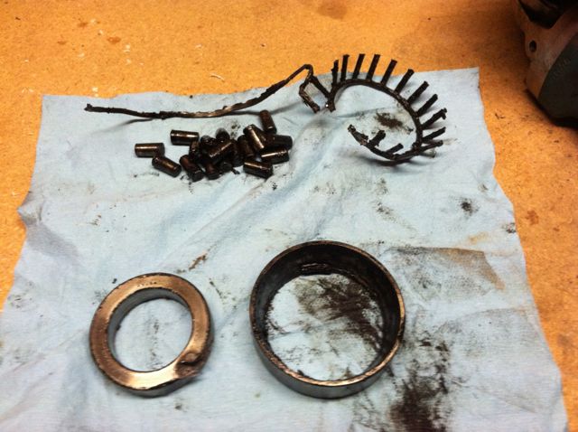

This is what's left when you do it the factory way:
Well That's about enough of that. This is why there are places called So and So's Axle and Driveline. Took them about half a day and voila, you get this:

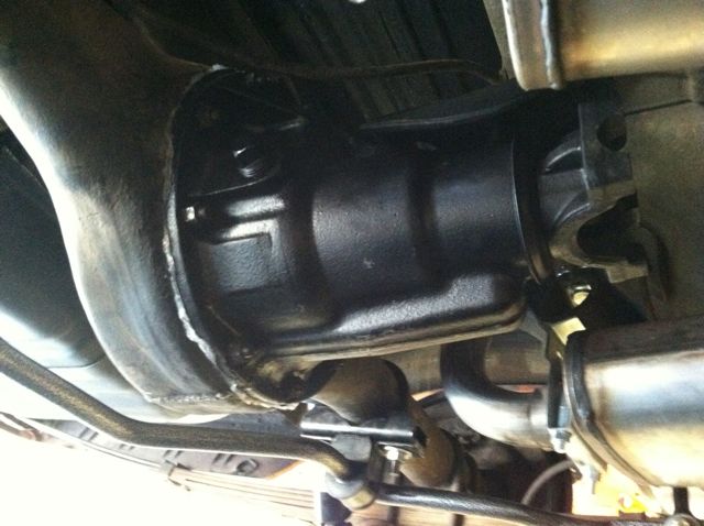

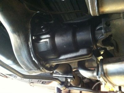

So I waited two days for the swelling and bruising to subside and had my son help me lift the new diff into place with the jack. No problems. It is nice working on gears that are actually an inch or more across. A slight bump against the housing is not going to hurt that thing! And the studs allow it to slide on perfectly. This is my kind of install. fits in one direction only with no adjustment. I used a FelPro gasket with liberal amounts of Permatex to make sure it won't leak. Why? 1.) I HATE things that leak, and 2.) I am NEVER going to do this again by myself on my back, so if the diff is a bit stuck, someone with a lift will be dealing with it!
Beautiful.

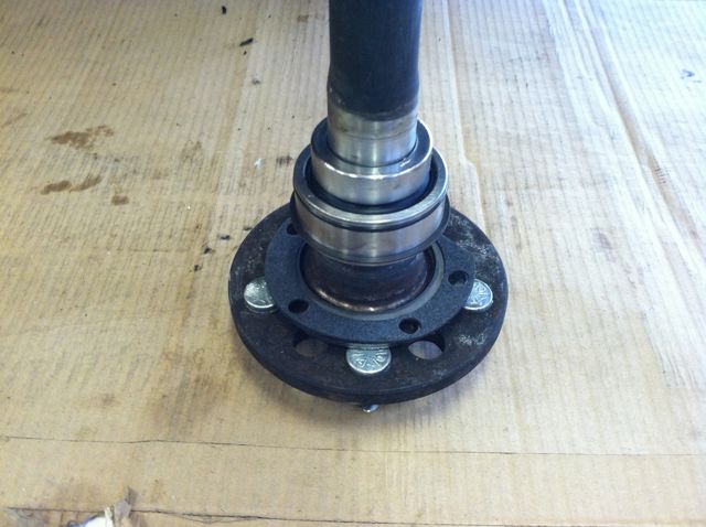

The axles went right back in. No adjustment with the Green bearings, so just tighten 'em em up - with a little bit of Permatex on the gasket for good measure. the last thing I did was add new gear oil to my new diff. Cass (Dr. Diff) recommended 85/140 conventional, so I bought enough for the 4.4 quarts shown in the service manual. I started with the rear of the car up in the air, but only got about 2 quarts in before the oil was coming back out the fill hole. I can't lower the rear or I'd never get the oil in (with the car sitting on the ground), so I raised the front. This did two things for me. First, it allowed me to get another quart of oil into the diff before it started to drip out the filler. Second, it allowed me to drain about a quart of trans fluid out of the automatic trans housing - oh yeah, did I forget to mention that I had taken out the driveshaft to change the U-joints? LUCKILY I had placed a pan under the trans when I removed the driveshaft in the first place.
One strange outcome though: I was only able to get 3 quarts of gear oil into the diff even with the car level. The service manual says it should take 4.4 quarts. Anyone know why this would be? Is there a quart+ of oil that was still inside the axle housing even though I had the differential off? I didn't go to any effort to drain or dry it other than removing the differential. Anyone have an idea? How do I know FOR SURE that there is enough oil in there? I guess I need a lift...

Check your service manual again
Mine says 4 PINTS (3 1/4 Imperial)
Oh. Well. Uhhh... I better check again. I guess there's little chance of overfilling it, since it runs right back out!
Yeah. It's pints. 4.4 of them.

I currently run the NON adjustable axle bearings but am looking to go back to the timken roller bearings. I have about 8000 miles on these axles and am on my second set of bearings. These type just do not last. The physics tell the tale. The "Green" brand as well as ones from other vendors use a series of ball bearings with a fraction of the contact area of the tapered Timkens. No wonder they wear out like a paper towel hat in a rainstorm.

When you go from Green type back to Timken type bearings, how do you get the "crush sleeve" into the center of the differential? From the looks of my stock diff, and from reading about it, there's a part in the diff that goes between the axle ends when you are running adjustable bearings. It seems to be called the crush sleeve. Tell me I don't have to pull the diff to put one in if I switch back???
I believe the crush sleeve is a part that is used with the install of the pinion shaft. Maybe what you are thinking of is the "Thrust Button"? I still have the thrust buttons in all of the 8 3/4" gearsets that I have here. I am currently using a '489 case with 3.91 gears and a clutch type LSD.

On the Greens, I'm thinking that True Trac doesn't have a thrust pin in the center so you're stuck using that bearing. When it first came out, it was a drag racing deal since a ball bearing takes less (robs less) power to turn but like Greg C mentioned, the Timkens are way more durable and will hold up to high cornering loads. Other manufactures also used ball bearings on their axles and yes, they were usually a higher maintenance item.
As for a crush sleeve...it's a pinion shaft part that only the 89 case uses....the axle thrust pin is what you need inside the 3rd member that's needed when tapered roller bearings are used and all the 3rd members need one when Timkens are used.
