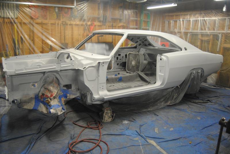

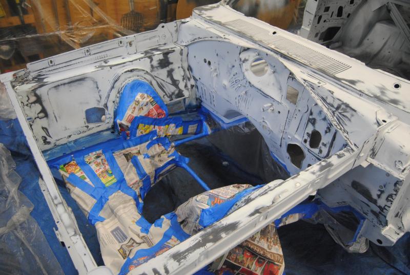

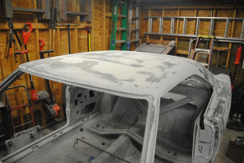

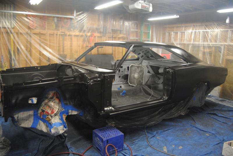

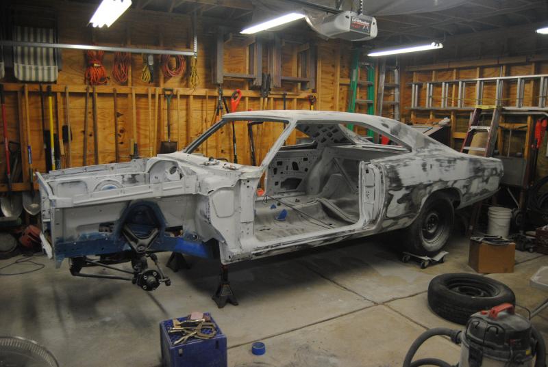

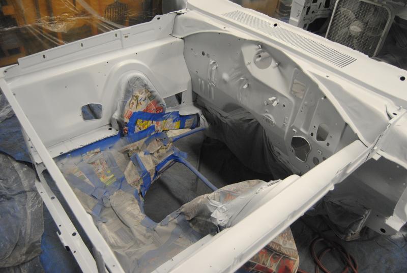

Hey gang! Thanks for the comments. Benn busy since my last post. Finished sanding the welded body except for the rear wheel wells and the interior area. Got it pretty well smoothed out. Those file boards really show where the highs and lows are. Everything looks good except for the quarter to roof joints that I just can’t get it right, so I’ll leave those to the professionals. Running out of warm weather to paint so I wrapped it up and got the guns out. Hit it with a coat of DP90 for bare metal and to bond to the old DP90, then 4 coats of K36 to fill all the scratches and little nicks. I goofed up some of the finish paint I put on the frame and shock towers so I’ll be repainting the whole front inner clip in the future.

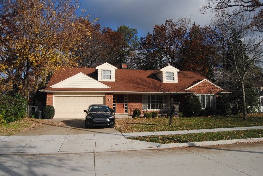

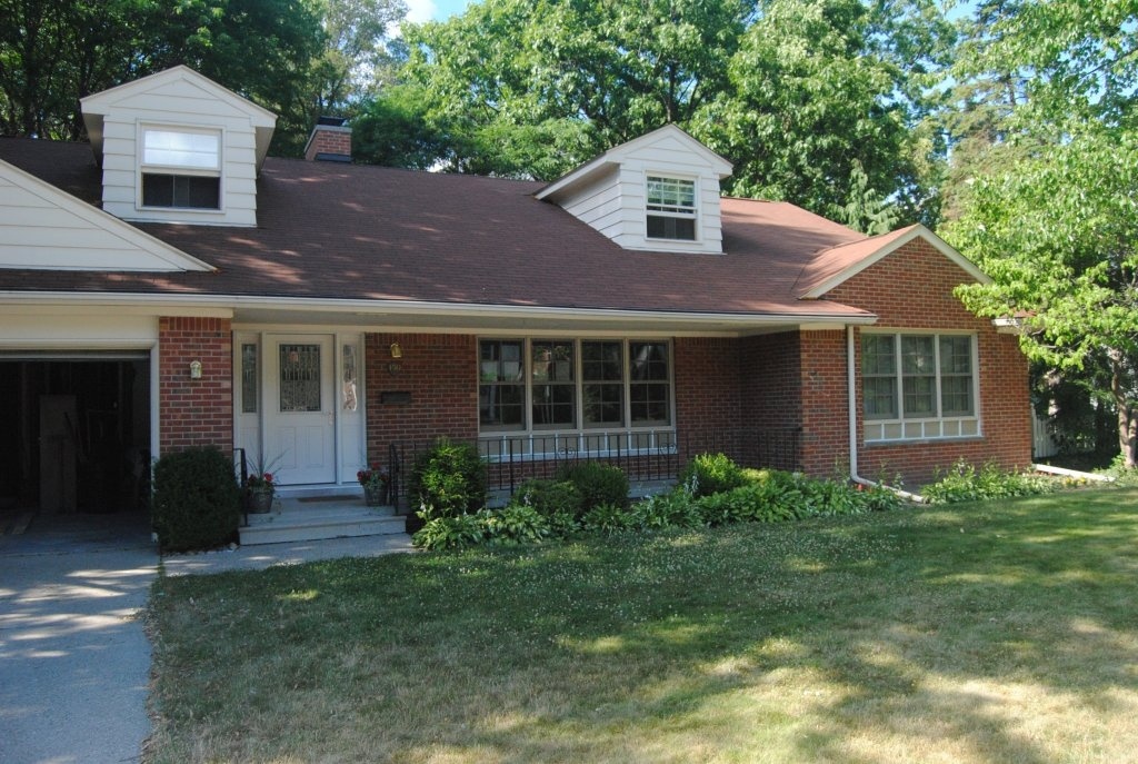

House on closing day November 2015.

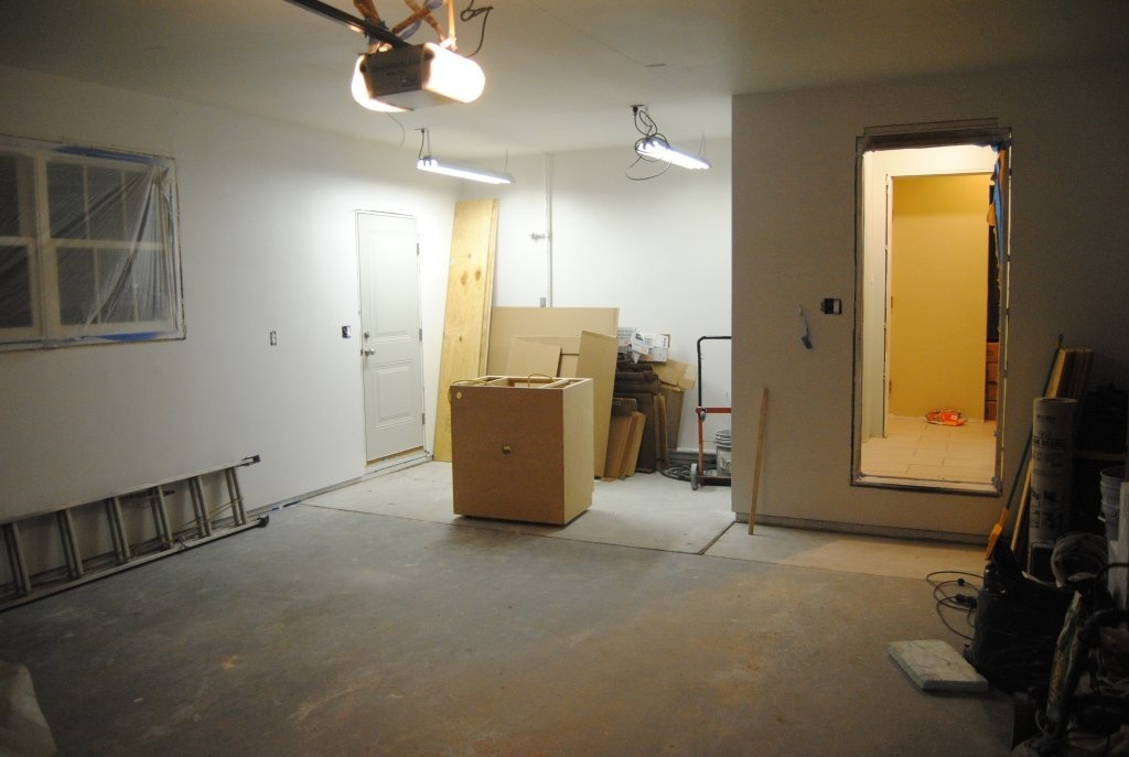

New garage with expansion area.

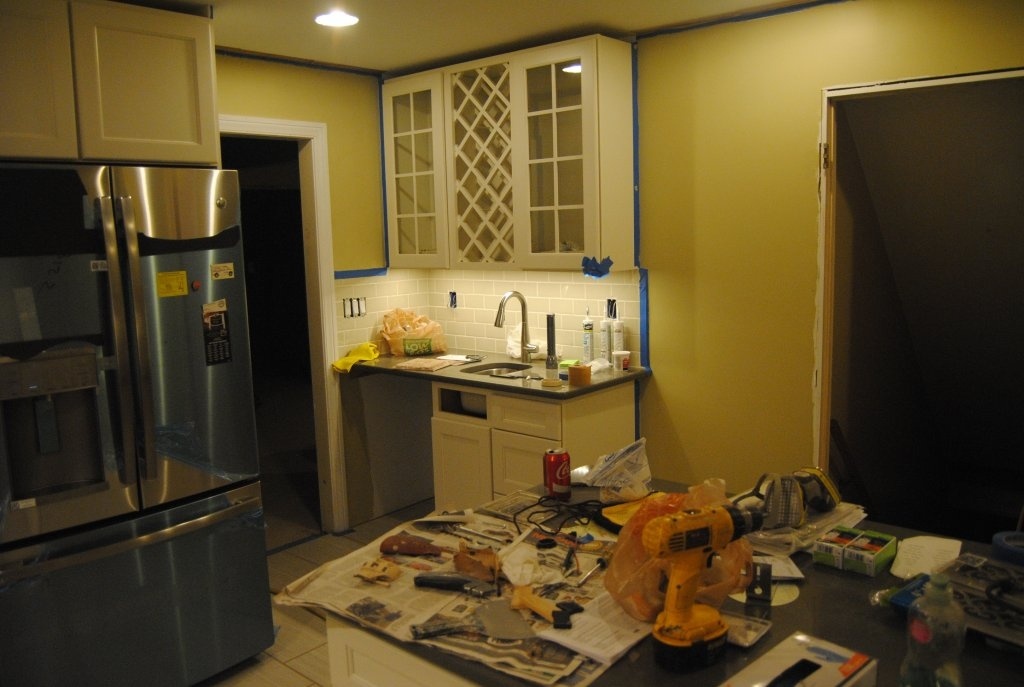

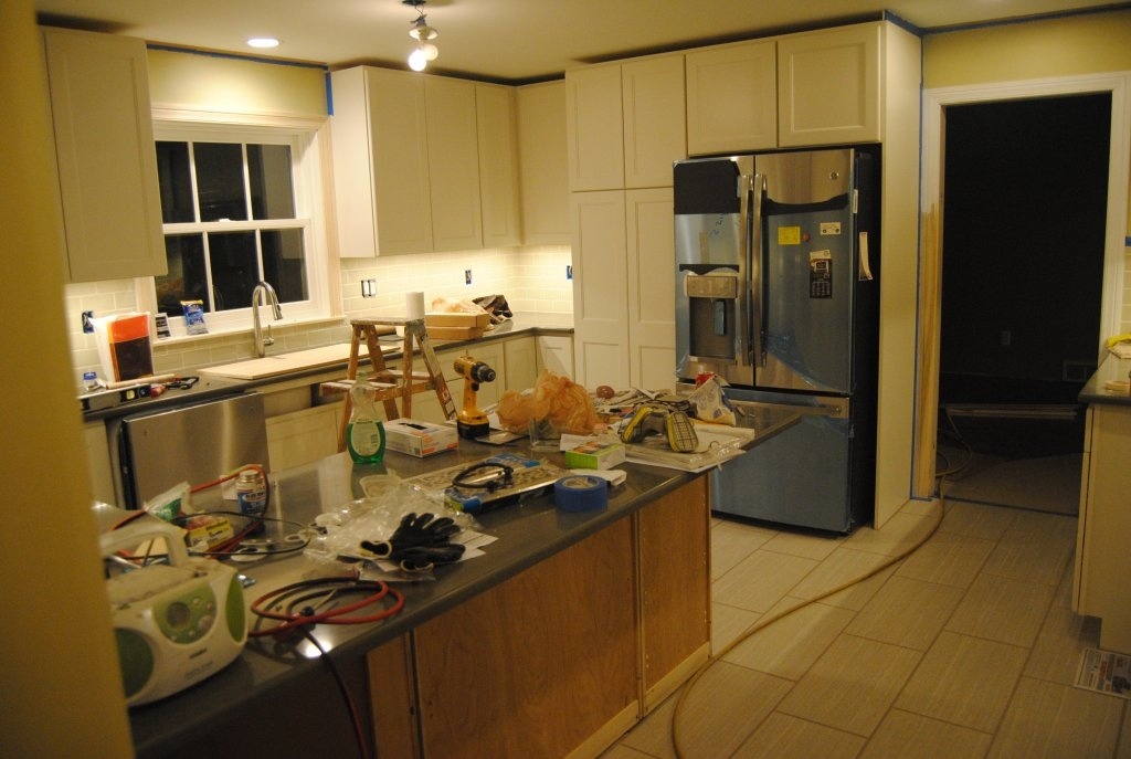

New kitchen.

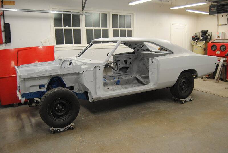

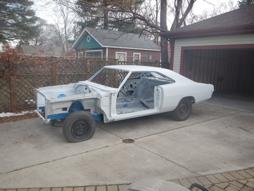

Charger ready to go. So sad with the flat tire...

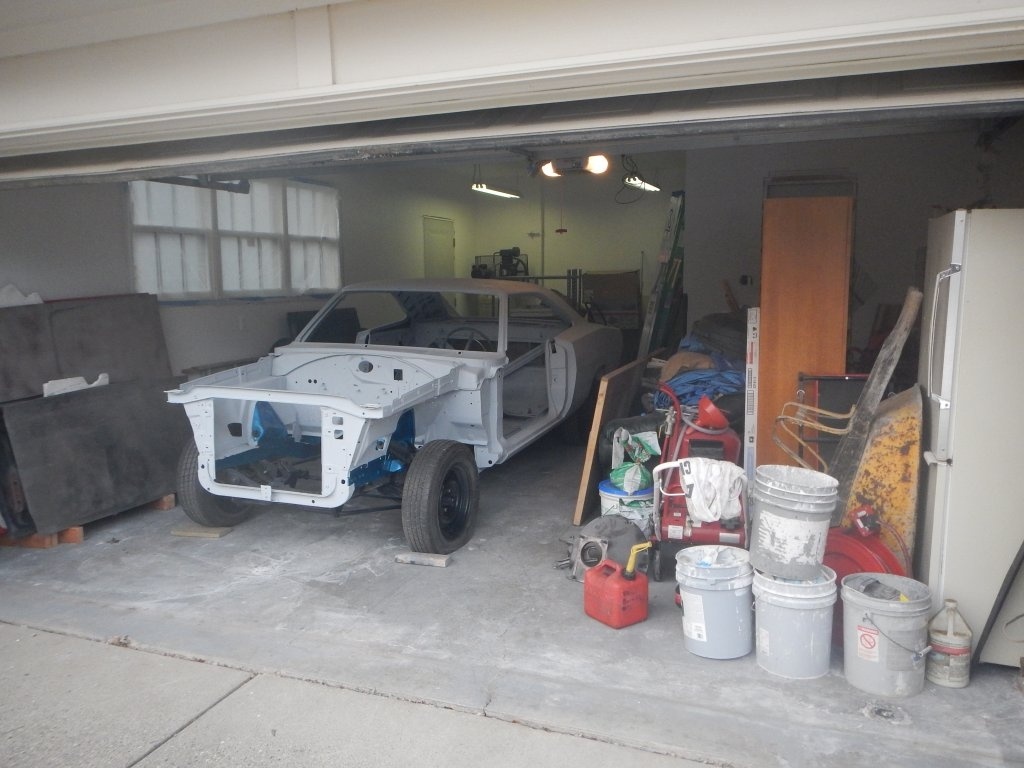

Charger's happy new home. A little crowded.....

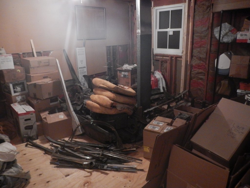

Plenty of parts storage space on the unfinished 2nd floor.

It was a sad day when we loaded up the charger and moved it out of the garage I’ve been putting it back together in and brought it over to the new place. But with an insulated garage I’ll install a gas heater for winter work. Not sure if I will be able to paint in this garage, or at least not that much. Will need to develop something for air exhaust. A few pics of the new place and moving of the charger below. As you can see we have a bit more purging / putting stuff away before I can start work on the charger again.

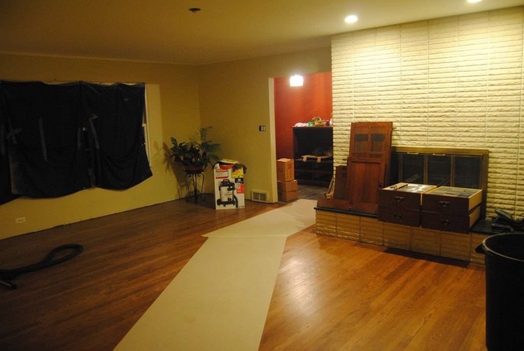

Living room.

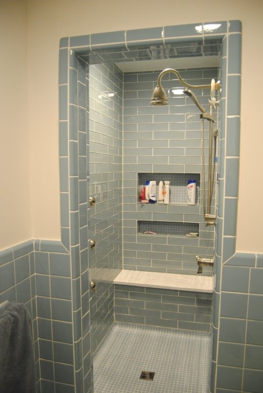

Much larger master shower.

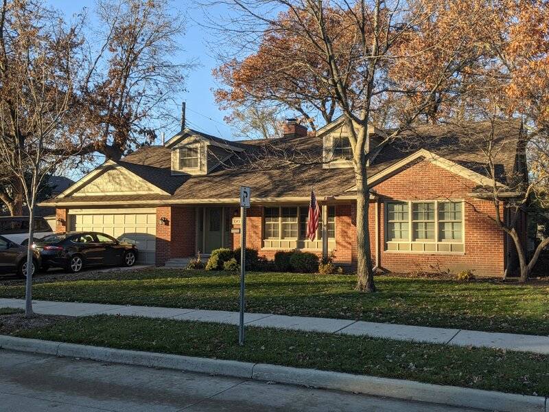

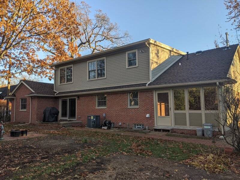

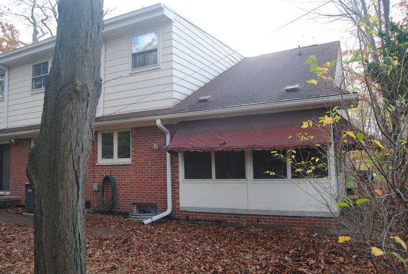

Over six years since I've worked on the car and almost five years since my last post here. What has this guy been up to? Well, the never-ending house renovation is the answer. But the light at the end of the tunnel is getting closer. Spent from spring of 2018 to spring of 2020 on exterior siding and such on the upper part of the house. What a rotten mess, literally. I never saw so much rotten wood. My roofer had to replace about 20 sheets of plywood and that's over what I had to do for the eve rebuilding I did. But it all looks good. Before and after pics below.

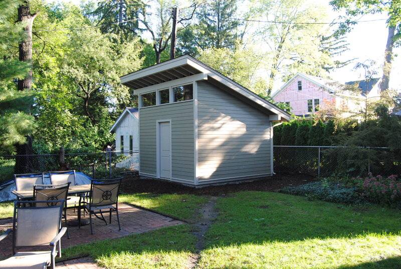

This year we built the nicest shed the building inspector ever saw and started getting the yard ready for landscaping next summer (bush and tree removal).

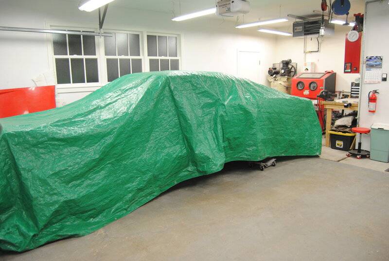

In the fall I installed a gas heater in the garage. HEATED GARAGE! You know what that means? Work on the car will be starting again!!!! Been watching Graveyard Carz and learning a lot about the OEM stuff that I want to replicate. But with that education I learned I have some issues to resolve. Plus, my wonderful wife asked for AC. So, I need to make some modifications to the fire wall for that. I know a 440 4spd would have never had AC, but it's not a number matching car so what the heck. I like AC on those hot summer days and don't like sticking to the seats anyways. Happy wife = happy life.
Here is what the car has looked like for the last six years.
And now for the unveiling....
Stay tuned for the progress. At least thru the winter...
