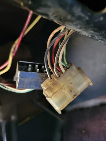

A couple hours. That includes repairing the threads in the holes where the wheel puller bolts go. I don't think the wheel has ever been off but someone buggered the threads trying. Make sure you set up a fish string as you remove the old wires. Also make a sketch and take pictures of the wires in the connector. The SM102 wires were the same color as the vehicle harness.

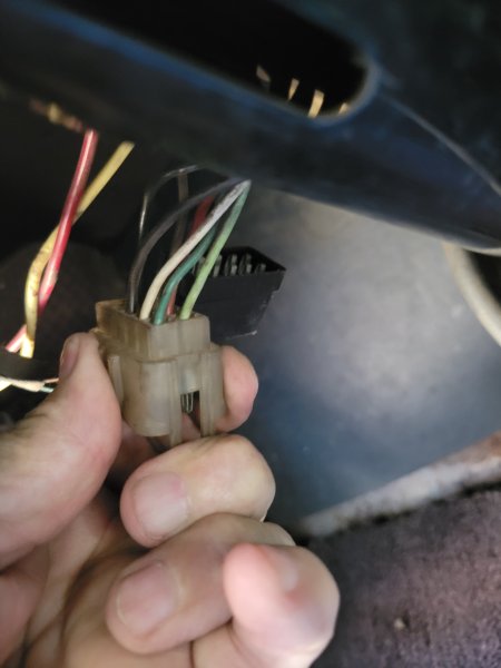

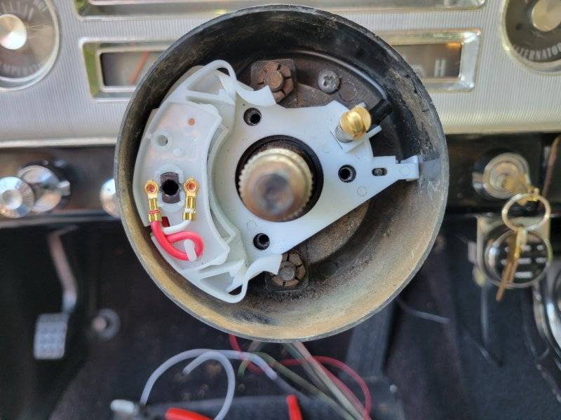

Well, I got my switch installed. (it was a OER brand) I still have brake light issues. Is it the switch, my installation, or a wiring or ground issue somewhere else? One side of the brake lights won't work at times. It's intermittent and seems to be related to using the turn signals. I also noticed that (at times) I would turn on the left turn, spin the wheel to cancel it and the right turn signals would then blink. I had to wiggle the lever to shut them off. To me that points to a defective switch. If both sides of the brake lights work, one side or the other won't after using a turn signal. It was also doing that with the old switch and many here said by replacing their switch, that issue was fixed. Crazy stuff. I have a PM into slantsixDan to see if he has some good switches yet. Sorry I'm so long winded.
Sorry to hear that. That looks exactly like the Shee-Mar switch. I was surprised to hear that the Shee-Mar is made in the USA. It may not matter much but did you trim the plastic so that it would fit around those castle nuts inside the column? And there was a metal plate that went on before the screws, correct? I think Dan has some 62-63 stitches that are the same but you would need to change all the terminals to your style.
I might end up with a Shee-Mar (sounds like a Chinese name) I was surprised there was a tech department you could talk to. I looked closely at the castle nut fit. The flats on the nuts on mine were in the right place so the base could sit flat. I did put the plate on and then the screws. I could see the toothed washer marks on it so it went back the same way it came off. I think I put everything back in it's place but I am a bit out of practice. May be Slant6Dan has a switch or knows where to get one. I can switch the terminals if needed.
Like I posted above Shee-Mar knows that there are issues with the switch. It sounds like there is very little room for error in the alignment of the contacts. I was happy that the switch completely solved my wonky brake lights and now about 95% of the time the signals work fine. The only "issue" is that occasionally I find the spot not quite into the RH turn position where the brake lights flash. They know about that.
