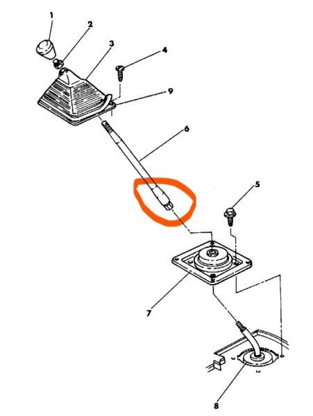

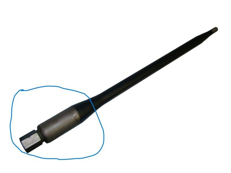

I dont have the shifter out of the truck at the moment; still driving it; but; it is very similar to this picture; other picture is from the parts diagram;
Basically the rubber bushing is inside the lower larger diameter part of the shifter, and the shaft that connects it to the transmission fits into the bushing; circled in blue. Its completely shot so the shifter has a bunch of extra play.
Can't you cut the bushing area off the stick and weld on a threaded, solid steel replacement? Just let it vibrate more.
